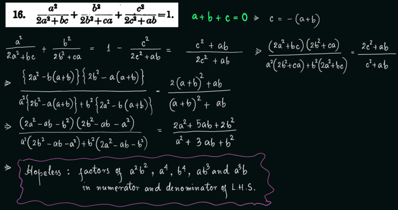

If ##a+b+c=0##, show that ##\boxed{\frac{a^2}{2a^2+bc}+\frac{b^2}{2b^2+ca}+\frac{c^2}{2c^2+ab}=1}##
1. If ##a+b+c=0##, then ##a^2+2ab+b^2=c^2##
2. If ##a+b+c=0##, then ##a^2+b^2+c^2=-2(ab+bc+ca)## (not sure how useful this would be)
Problem statement :
I copy and paste the statement of the problem from the text.
(Given ##\boldsymbol{a+b+c=0}##)

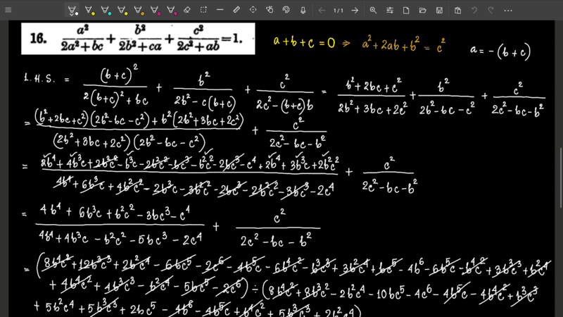

Attempt : I am afraid I couldn't make any meaningful progress. With ##a = -(b+c)##, I substituted for ##a## in the whole of the L.H.S, both numerators and denominators. I multiplied the denominators and multiplied the numerators by the "other" denominators, much as we would do for the case ##\dfrac{A}{X}+\dfrac{B}{Y}+\dfrac{C}{Z} = \dfrac{AYZ+BZX+CXY}{XYZ}##. That gave me three terms with sizable numbers of terms in the numerator and denominator, ranging from ##b^6\rightarrow c^6## and terms of decreasing and increasing powers of ##b,c## respectively in them. It was clumsy and tedious, not to mention that I didn't obtain the answer 1 due to what must be an error somewhere. I am certain there must be a better way to do the problem.
Request : Not having done my fair share, I would be happy for the barest of hints in the right direction to get me going.

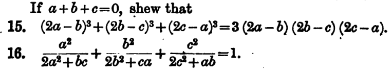

If I see that 1+1-2=0 and then the first term (your A/X) does not exist, it seems to me you haven' t given us the complete problem statement.
And I don' see 6th powers emerging ?
BvU said:
If I see that 1+1-2=0 and then the first term ( your X) does not exist, it seems to me you haven' t given us the complete problem statement.
Please see Problem 16 below taken from the text.

I don't know how clear it is. You will see terms like ##-4b^6## and ##-2c^6## in the last line.

I think you have to be a bit smarter. I took ##c = -(a + b)##. And took the third term over to the RHS. I.e. show that $$A + B = 1 - C$$It then looked easier to invert the two fractions and show that $$\frac{1}{A + B} = \frac 1 {1-C}$$That got rid of some factors and the rest was not too bad.
I can't see a quick and easy way to do it, although there must be one.

Here's an idea. Still messy, but the best I can do. All of these steps are backwards implications (or "enough to show"):
$$\frac{a^2}{2a^2 +bc} + \frac{b^2}{2b^2 +ac} = \frac{c^2 + ab}{2c^2 +ab}$$Now invert both sides:
$$\Leftarrow \ \frac{(2a^2 +bc)(2b^2 + ac)}{a^2(2b^2 +ac) + b^2(2b^2 +bc)} = \frac{2c^2 + ab}{c^2 +ab}$$$$\Leftarrow \ \frac{4a^2b^2 + 2c(a^3 + b^3) + abc^2}{4a^2b^2 + c(a^3 + b^3)} = 1 + \frac{c^2}{c^2 +ab}$$$$\Leftarrow \ 1 + \frac{c(a^3 + b^3) + abc^2}{4a^2b^2 + c(a^3 + b^3)} = 1 + \frac{c^2}{c^2 +ab}$$Cancel the ##1## and invert again!
$$\Leftarrow \ \frac{4a^2b^2 + c(a^3 + b^3)}{c(a^3 + b^3) + abc^2} = \frac{c^2 +ab}{c^2}$$$$\Leftarrow \ 1 + \frac{ab(4ab - c^2)}{c(a^3 + b^3) + abc^2} = 1 + \frac{ab}{c^2}$$$$\Leftarrow \ \frac{(4ab - c^2)}{c(a^3 + b^3) + abc^2} = \frac{1}{c^2}$$$$\Leftarrow \ c(4ab - c^2)= a^3 + b^3 + abc$$And, finally, we set ##c = -(a + b)## to confirm that last equality

I have bad news. I have been trying to splve using @PeroK 's solution earlier above (post #7). I used ##c=-(a+b)## on both sides and reduced both L.H.S and R.H.S exactly as asked but am stuck.
Attempt : I present my attempt below. I hope it's readable.
A help at the last step would be welcome.
