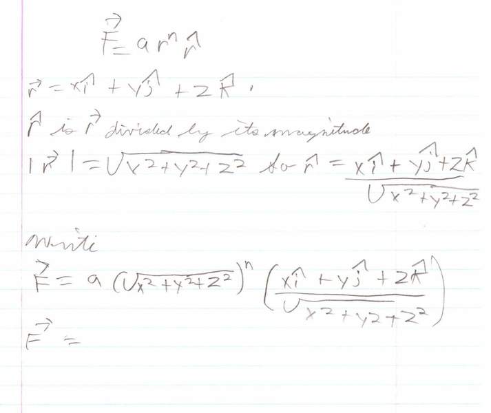

F = a(r to the n)(r hat) Prove F is conservative. Please show steps.

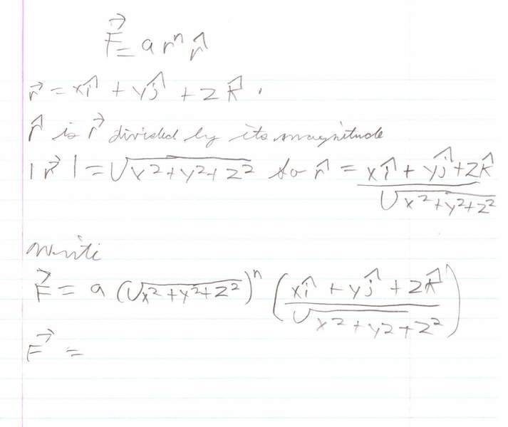

Here is what I have done so far. Can you please show me how to finish this problem because it is due at 4 today. And thank you for all the help.

Now what are the characteristics of a conservative force? If you look in your book, they probably have a list of several things that are true about conservative force fields; what you need to do is to prove that one of those is true. Which property would be easiest to prove is true for this problem?
The teacher wants us to show mathematically that it is conservative so the partial fractions Fx/y must equal the partial fraction of Fy/x etc. Please help me finish this problem and thank you!
Okay, so you're almost done. You have written out the force F in terms of x, y, and z.
There are really only two steps left. What is the x component of that force that you wrote out?
And what is its partial derivative with respect to y, which is [tex]\frac{\partial F_x}{\partial y}[/tex] ?
That last answer might look a bit messy, but once you do those steps for all three components (you'll end up with a total six derivatives to take) you'll see that they'll all cancel in pairs.
So I don't have to simplify the problem I can take the partial derivatives of what I have. (I am asking because I thought that I had to get one big fraction) Also if I am allowed to take the partial fractions now I can do this for all the requirements for the force to be a conservative force. Please help me finish the problem and thank you for the help.

I would simplify your force formula a bit, by combining the two square roots (the one in the numerator and the one in the denominator) into one square root.
I'm not quite sure what you're asking, but once you have the x component of the force, you can just take its (partial) derivative with respect to y; and once you have the y-component of the force you can take its partial derivative with respect to x. If the force is conservative, those should cancel.
You then check the other four possible derivatives the same way. What do you get for these steps?
How do I combine the square roots because the one in the numerator is to the n.
You have n in the numerator, and one in the denominator, so the total will be n-1. And you can also pull out the square root part into the exponent, so:
[tex]\frac{(\sqrt{x^2+y^2+z^2})^n}{\sqrt{x^2+y^2+z^2}}\Longrightarrow (x^2+y^2+z^2)^{(n-1)/2}[/tex]
