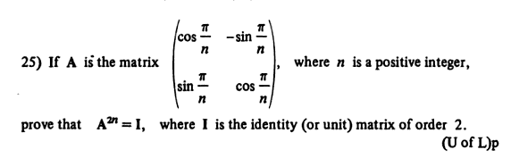

I understand that matrix in the form of A as above represents a rotation about the origin.. but for this question, I am actually clueless on what method should i use to prove it... Any hint?
Seems like a natural for an induction proof.
It looks to me to be almost trivial! What is [itex]A^2[/itex]? [itex]A^{2n}= (A^2)^n[/itex].
