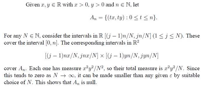

In the argument I posted to show that the set [itex]\{(tx,ty) : 0\leq t \leq n \}[/itex] is null:
why is the measure of each interval [tex]I_n = \left [\frac{(j-1)nx}{N} , \frac{jnx}{N} \right] \times \left [\frac{(j-1)ny}{N} , \frac{jny}{N} \right][/tex] given by [tex]|I_n| = \frac{x^2y^2}{N^2} \;?[/tex]
The measure of intervals in [itex]\mathbb{R}^2[/itex] is the product of the measure of the 2 intervals in [itex]\mathbb{R}[/itex] so [itex]|I| = |I_1|\cdot |I_2|[/itex].
The measure of an interval [itex]I=[a,b][/itex] is [itex]|I|=b-a[/itex] so the measure of [tex]I_1= \left [\frac{(j-1)nx}{N} , \frac{jnx}{N} \right][/tex] is [tex]|I_1| = \frac{jnx}{N} - \left(\frac{jnx}{N} -\frac{nx}{N} \right) = \frac{nx}{N}[/tex] and the measure of [tex]I_2= \left [\frac{(j-1)ny}{N} , \frac{jny}{N} \right][/tex] is [tex]|I_2| = \frac{jny}{N} - \left(\frac{jny}{N} -\frac{ny}{N} \right) = \frac{ny}{N}[/tex] so the measure of each [itex]I_n[/itex] is [tex]\frac{nx}{N}\frac{ny}{N} = \frac{n^2xy}{N^2}[/tex] but they have it as [tex]\frac{x^2y^2}{N^2}[/tex]
They were just being sloppy. Yes, it should be n^2*xy/N^2. It doesn't change the conclusion.
