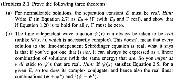

(a)
$$ \Psi (x,t) = \psi e^{-i(E_{0} + i \Gamma)t / \hbar} $$
$$ \mid\Psi (x,t)\mid^{2} = \Psi^{*} \Psi = \mid \psi \mid^{2} e^{2 \Gamma t/ \hbar} $$
Using equation 1.20
$$ e^{2 \Gamma t/ \hbar} \int_{-\infty}^{\infty} \mid \psi \mid^{2} dx = 1 $$
This equality only holds true for all time if ##\Gamma## is zero.

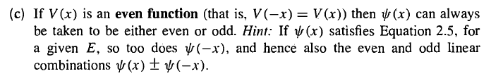

(b) & (c) I am having a hard time understanding what to do, but (c) looks a little easier (probably since it's a shorter question) so I will try it first
Using equation 2.5, it seems they want me to plug in
$$- \frac {\hbar^{2}}{2m} \frac {d^{2} \psi(-x)}{dx^{2}} + V \psi(-x) = E \psi(-x) $$
But now what??
In both b) and c) they want you to prove what's suggested by "If..." in the hint. So: not plug it in, but show that if ##\Psi(x) ## satisfies 2.5, then ##\Psi(-x)## does so too.
How do I begin to show that? I'm not sure what to start with
Well, E is a number, V is an even function. What about ##d^2\over {dx^2}## ?
It's an operator
edit: I'm sorry, the hints you are giving are just to me disjointed and I really don't know where to go with this. The best thing I can think of is to solve the schrödinger equation with the argument of -x.
Don't go solving. Just swap x and -x (perhaps that's what you meant to say), knowing ##\psi(x)## is a solution.
So I just say
$$ - \frac {\hbar^{2}}{2m} \frac {d^{2} \psi(-x)}{dx^{2}} + \psi(-x) [V(-x) - E] = 0 $$
So I know ##V(-x) = V(x)##, but how does this prove ##\psi(x) = \psi(-x)##? I mean, I suppose ##V - E## will have to be the same for either an argument of ##x## or ##-x##, so for this equation to be equal to zero, then ##\psi(x)## will have to be the same as ##\psi(-x)## in order to maintain equality with equation 2.5. This seems trivial and hand wavy...
no, you can prove it, not just by handwaving. Start by assuming that ##\psi (x)## is a solution, then prove that ##\psi (-x)## is a solution. Hint: substitute ##-z=x## into the original equation.

yes. First you must prove that ##\psi(-x)## is a solution. Then after that, you can start thinking about linear combinations. So just start with the first bit. Assuming that ##\psi(x)## is a solution, prove that ##\psi(-x)## is a solution.
I don't understand how to do that. So I will go with your first post and substitute ##x = -z##
$$ - \frac {\hbar^{2}}{2m} \frac {d^{2} \psi(-z)}{d(-z)^{2}} + [V(-z) - E] \psi(-z) = 0 $$
But now what?
In reply to #12:
My head hurts too :confused: for a different reason. Feel guilty about both :wink:. Fortunately Bruce is here to keep us sane...
Thing to show is that if ##\quad \psi(x)## is a solution ##\Rightarrow\quad \psi(-x)## is a solution too ##\quad##, right ? From there, combinations are, so we might as well look at odd and even solutions only when searching for solutions of 5.2. There may well be solutions that are not either odd or even, but those solutions can always be written as linear combinations of odd and even functions.
In other words: if we've shown that if ##\psi(x)## is a solution ##\Rightarrow\quad \psi(-x)## is a solution too, we've shown that for any arbitrary solution the even part and the odd part are both solutions. So in a search for solutions to 2.5 we can confine ourselves to all even and all odd solutions without missing any solution at all.
Now on to showing: perhaps it helps if we swap x for y. Corny. We get $$
- \frac {\hbar^{2}}{2m} \frac {d^{2} \psi(y)}{dy^{2}} + V(y) \psi(y) = E \psi(y)
$$then we swap y for something else, e.g. -x :smile:. Corny too ? We get $$
- \frac {\hbar^{2}}{2m} \frac {d^{2} \psi(-x)}{d(-x)^{2}} + V(-x) \psi(-x) = E \psi(-x) \qquad (1)
$$and now I hope I have found the right path to show you:
  • V is even, so ##V(-x) = V(x)##. Then:
  • If you remember that ##{\partial \over \partial (-x)} = - {\partial \over \partial x}##, then what about
##\partial^2 \over \partial (-x)^2## in relation to ##\partial^2 \over \partial x^2## ? Right ! Eureka ! So
- \frac {\hbar^{2}}{2m} \frac {d^{2} \psi(-x)}{d(x)^{2}} + V(x) \psi(-x) = E \psi(-x)
and this is the same equation for ##\psi(-x)## as 2.5 is for ##\psi(x)##.
In spite of the ##V(x)## looking out of place: now you can fill in a value for x to convince yourself that ##\psi(-x)## at x = 5 behaves itself according to the same
differential equation as ##\psi(x)## at x = 5
