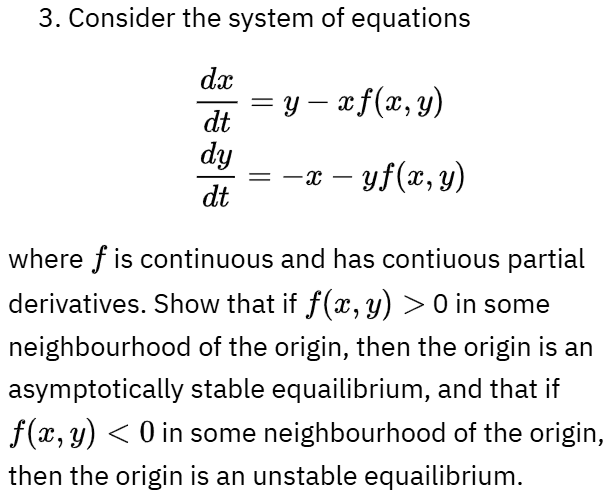

Please see below
Please see below
For this problem,
My solution is to find the characteristic equation of the system by putting the system into a matrix. This gives ##\lambda^2 + 2f \lambda + f^2 + 1 = 0##
Then each eigenvalue is ##\lambda_1 = -f - i## and ##\lambda_2 = -f + i##
I then want to find the Jacobian, however, I would need to find the partial derivatives (with respect to x and y) of ##F(x,y) = y - xf(x,y)## and ##G(x,y) = - x - yf(x,y)##, however, I'm not sure how to do that with the ##f(x,y)## in there.
Does anybody please know what I should do?
Thanks!
You don't need to look at the Jacobian; the fact that the question tells you nothing about the partial derivatives of [itex]f[/itex] is a strong suggestion that this is the wrong way to proceed.
When I see scalar multiples of [itex](x,y)[/itex] and [itex](-y,x)[/itex] on the right hand side, I immediately think of polar coordinates [itex](x,y) = (r \cos \theta, r \sin \theta)[/itex]. This is because [tex]\begin{split}<br /> r\frac{dr}{dt} &= x\frac{dx}{dt} + y\frac{dy}{dt} \\<br /> r^2\frac{d\theta}{dt} &= x\frac{dy}{dt} - y\frac{dx}{dt} \end{split}[/tex] so that the coefficient of [itex](x,y)[/itex] tells you how [itex]r[/itex] behaves and the coefficient of [itex](-y,x)[/itex] tells you how [itex]\theta[/itex] behaves. If [itex]\dot r < 0[/itex] the origin is asymptotically stable; if [itex]\dot r > 0[/itex] the origin is unstable.

Thank you for your reply @pasmith!
That is a interesting idea that I have not seen before. They have taught me to me so far to methods to find the stability of a non-linear system of equations, to either use the Jacobian matrix for linearization to find a equivalent linear DE system to the non-linear DE system or use the direct method.
If I think about for the later method, we could also try to solve this problem by using a Liapunov function of the form ##V(x,y) = dx^2 + dy^2 = d(x^2 + y^2)##? If that does not work then I could generalize to more coefficients, ##V(x,y) = dx^2 + gy^2##?
