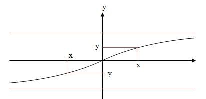

Prove:
$$\tan^{-1}(-x)=-\tan^{-1}(x)$$
Graph of an odd increasing curve through the origin, with horizontal guide lines at y = plus or minus a level, showing points x and -x on the horizontal axis and their outputs y and -y on the vertical axis.
Inverse tangent: ##\tan(y)=x~\rightarrow~y=\tan^{-1}(x)##
$$\tan(-x)=\frac{\sin(-x)}{\cos(-x)}=\frac{-\sin(x)}{\cos(x)}=-\tan(x)$$
I just change the unknown x to y:
$$\tan(-y)=\tan(y)$$
Now i have to translate it. we know:
$$\tan^{-1}(x)=\tan y~\rightarrow~-\tan^{-1}(x)=-\tan y$$
But:
$$\tan^{-1}(-x)~\rightarrow~\tan(y)=-x$$
Only from looking on the graph i can say ##\tan(-y)=-x## and finish but am i allowed to?

In a formal proof you cannot look at a graph to make conclusions. You only can use them to illustrate your proof but your proof should stand on its own.

A function must be 1-1 to have an inverse. Normally, by restricting the domain of a function, you can make it 1-1 on the restricted domain. Like ##\tan(x)## on ##(-\pi/2, + \pi/2)##.
I don't think you can say that a function and its inverse have nothing in common. They are very closely related.
