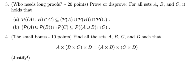

how do I go about doing 3(a) and 3(b)?
I'm guessing that for 3(a), it is true, since we have for LHS:
P((A or B) and C)
we can consider the case P(A and C) by excluding B, and this is a subset of the RHS when we also exclude B: (P(A) and P(C)).
We can consider excluding B because it's in an OR function.
Thanks x

  • Typeset problems 3 and 4 from a set theory and Cartesian product exercise set; problem 3 asks to prove or disprove two power set inclusions, and problem 4 asks to find all sets A, B, C, D with A x (B x C) x D = (A x B) x (C x D).

When you exclude B from the left hand side you make the left hand side smaller - So the question is asking you to show that X is a subset of Y, and you showed that W is a subset of Y where W is a smaller set than X is.

I've managed to do 3(a), it is false. I used the counter example: A= a, B= b, C = a, b.
How do I do 3(b)? 3(b) is 3(a) reversed.
I'm pretty sure 3(b) is true since the RHS will always end up being 'larger', but i don't know how to go about proving it.
