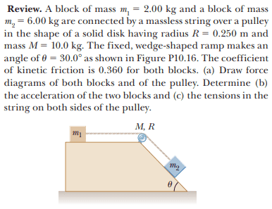

For this problem,
Why is the tension on each side not equal?
For this problem I think the only assumption is that the string is inextensible so the accelerations of the masses are equal.
Many thanks!

They are merely asking you to calculate each tension without assuming that they are equal. (Yes, they will end up being the same.)
Just to clarify, the second of the three "they" refers to the accelerations which will end up being the same, not the tensions.

What makes you think that the tension on each side would be equal?

The accelerations are the same since we are making the assumption that the string is inextensible, correct?
Many thanks!
Callumnc1 said:
Thank you for your reply @kuruman!
Many thanks!
Yes.

I have never solved a pulley-mass problem (that I'm aware of) where the tensions on each side have the same value. So I don't know how to tell whether the tension will be equal or whether it won't.

In those problems, in which the tensions were equal, how were the pulleys described?
What's different about this pulley?

I can't really remember much about the textbook problems, but I think they were Atwoods machines.
I think the pulley was frictionless and had infinite rotational inertia, so it did not move and only changed the direction of the tension. But then when a search it up, the pulley dose not actually have infinite mass, but is massless. I guess it does not really matter since we are assuming that where the string comes into contact with, the pulley there is no friction.
I guess what is different in there problem is that there is a non-negligible force opposing the masses (the kinetic friction) and the important part is the pulley has a mass M. Therefore, the pulley will have a rotational inertia. I think they must be assuming that the pulley has static friction that there is a torque on the pulley which means that one tension must be greater than the other tension.
