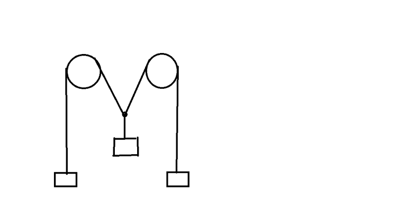

Hi, If i have a system that consists of 2 pullies and 3 masses, what is the tension on each part of the string? I know that for 2 masses hanging on either side of a pulley, the tension is the same. But for 3 masses, and 2 ideal pullies(no friction) and inextensible string, is tension the same too at every point on the string? I have attached a diagram to explain the problem.

The tensions need not be the same because the string seems not to be continuous at the middle mass. It looks like you have two separate strings attached to the same point on ##m_2.##

ok so we have 2 different values for T in this case? Sorry I'm new to this website.

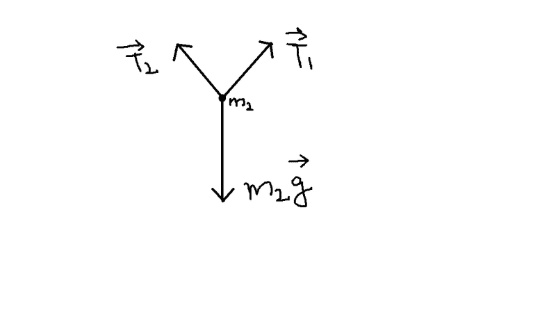

You need to start by drawing a Free Body Diagram of ##m_2##. Can you show us that FBD? Is the system stable or in motion?

there are 3 forces acting on m2 , t1 t2 and it's weight. I'm not sure if t1 and t2 are equal or not. That's why i posted this question. I know for a single pulley system, the tension is the same on both sides but here we have 2 pullies and 3 masses.
Does ##m_2## accelerate? If not, what must be true about the forces acting on it?

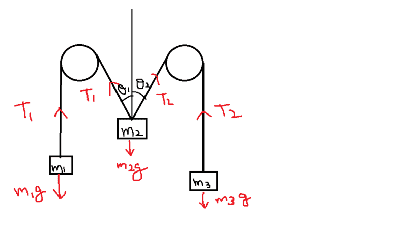

Here's the figure with all the forces, t1 is same on either side of pulley(I'm treating it as if it was a 2 mass system so tension is the same on both sides) and t2 same on either side for the second pulley. That's what I did initially. I'm not sure if it's correct.

forces in y direction must be balanced i.e m2g= t1 cos a1 + t2 cos a2.
the tensions are reversed in my FBD, t1 is on the left and t2 on the right.
Can you figure out the values for ##T_1## and ##T_2##?

Thank for clarifying the conditions. This is important. Now you need to specify what is given and what is required for this problem. The original question was answered, the two tensions don't have to be equal.
You diagram is correct.
Now, imagine what would happen if ##m_1=0##.
Alternatively, imagine ##m_3=0##.
Can you see that the tensions do not need to be equal in order to achieve balance?
They would only happen in a symmetric case, where ##m_1=m_3##.
Going back to your diagram, decompose each tension in horizontal and vertical components.
Then, do a summation of horizontal and vertical forces.

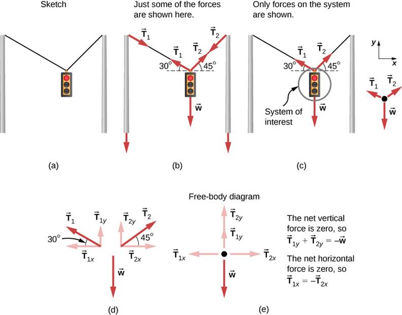

Please, see:
https://courses.lumenlearning.com/s...apter/6-1-solving-problems-with-newtons-laws/

sum of forces on m1 = ma so T1 - m1g = 0
T1 = m1g and T2=m2g.
Yes. That says that the tensions are not equal unless the hanging masses are equal. The pulleys are assumed to be ideal which means that they change the direction of the tension but not its magnitude.

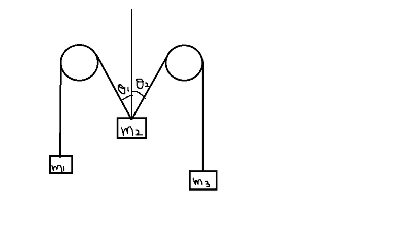

I'm wondering if we had another string connected to m2 like I've shown in the diagram we would have to introduce another tension T3? And that tension would depend on the mass m2 only or It would be affected by the tensions T1 and T2 and we would get some other value? Because if I work out the tension T3 for the system in equilibrium I get: T3=m2g. So even though that middle string is connected to strings of tensions T1 and T2 these 2 won't affect the tension in the middle string?

For the 3-mass 2-pulley system shown in post #1, as long as the system is in equilibrium, the tension in each string will be equal to the weight hanging from it regardless of whether the masses are equal or not. However, when the masses are equal, the angles are equal ##\theta_1=\theta_2## which will not be the case when the masses are different.

Yes. Adding a string to ##m_2## will not affect the fact that T1 and T2 add as vectors to give a resultant that is equal to the weight.
