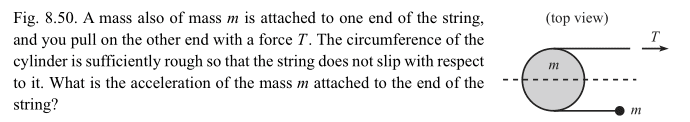

Basically, the problem is pretty easy if the constraints are understood, and this is my problem.
I am trying to figure out some relation between x, y, and theta. I don't know if seeing by this way is the better attempt.

It is unclear how you are defining x and y.
Seems to me there are three linear motions of interest. The constant that relates them is the length of the string. Write an equation to represent that.
There is also the angular motion of the cylinder, which relates to them through a second equation.

Is x is the position of the centre of the disk and y is the position of the small mass?
Take into consideration that the disk rolls on the piece of string, connected to m, but the string is also accelerating. Use the rolling condition for the motion of the disk
I can see 4 equations with 4 unknowns (the accelerations of point mass m and center of mass of cylinder, the angular acceleration ##\alpha## of cylinder and the tension ##T_m## in front of point mass m)
One equation is the kinematic equation that relates ##a_m,a_{CM}, \alpha##. In my opinion it is $$a_m=a_{CM}+\alpha r$$
Second equation and Third equation are Newton's 2nd law for the CM of cylinder and point mass m.
Fourth equation is the torque balance on the cylinder ##T_{total}=I_{CM}\alpha##

Hi you all, reviewing this problem and with a little of formalism, i solved it.
Thank you.
XYZ normal, counterclock positive
-T1 = mx''
(T1 - T)R = I*theta''
T + Ta = m*A
theta''*R = X'' - A
I got x'' = -T/4m ;) the answer

My method of solving is basically what you did at post #6. You can take the positive x-direction towards right and for the rotation counterclockwise.
Yes you are right with this sign conventions the correct kinematic equation is ##\alpha r=a_{cm}+a_{m}##.

Signs must be the biggest single cause of errors. Generally I recommend sticking to standard conventions like up, to the right and anticlockwise are positive, but when it is clear that a particular variable will turn out negative under that arrangement it can be less confusing to adopt a convention that makes each variable positive.
Whatever you choose, write it down!
In the present case, with the orthodox convention, and writing a for the particle's acceleration, we can anticipate that a will turn out negative:
Torques about cylinder’s centre: ##-(T+ma)r=\frac 12 mr^2\alpha##.
Straight away that looks weird. Why T+ma?
Since particle m accelerates at a to the right there must be a right-positive force ma acting on it. Therefore there is a right-positive force -ma acting on the bottom of the diagram of the cylinder. This exerts an anticlockwise-positive torque -mar on the cylinder. Since T exerts an anticlockwise-positive torque -Tr, the sum is -(T+ma)r.
The rightward acceleration of the cylinder is ##a-r\alpha##. Again, we can predict the rotation will be clockwise, so ##\alpha## will be negative.
So for the linear acceleration of the system, ##T=ma+m(a-r\alpha)##.
These lead to ##a=-\frac T{4m}##.
With the "positive variables" convention, it is all the same but flipping the signs of a and ##\alpha##.
