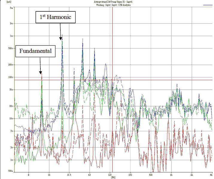

I am working on a new 45kW centrifugal water pump, which is >70C at the roller bearing pedestal. I wonder what' s causing such high temperature.
The vibration measured at the bearing pedestal is indeed very small. The pump seems to be well balanced and lubricated.
  • Log-scale amplitude spectrum plot in mA against frequency in Hz, with several coloured traces; labelled peaks mark the Fundamental near 12 Hz and the 1st Harmonic near 25 Hz.
if there is no real vibration, the bearing endplay/pre-load would be where I looked next. unless some "lands" around the bearing are causing the rubbing of other surfaces (bearing bore too deep, etc)

Let's get some more info on this one data point:
- Is this a new installation?
- Have you verified your instrumentation?
- pump speed =?
- # of balls in the suspect bearing = ?
- what kind of load, i.e. flow and pressure?
- Any other operational info
- Has the pump been recently serviced?
- Are you sure the bearing is cooled properly?
Usually an overtemp with low vibs is a sign of either too little or too much lubrication. In the case of too much, the scavenge of the cooling flow in insufficient to get the fluid away from the bearing so it just keeps heat soaking the bearing. It is especially important to look at recent maintenance and any other things that could have been done to the pump, i.e. its history.
Some additonal informations
Yes, both the pump and motors are new
The sensors were calibrated just before the measurement
- pump speed =?
740rpm
Roller bearing, 14 rollers dia 25.7mm, bearing pitch dia 132.5mm
Design flowrate is 0.35m^3/s, pressure head is 8m
I don't know exactly how long the pump is in service, i think it s about a week or two
I don't know the amount of lubricants. We would check with the pump operator if it is the suspicuous cause
Because this is a new installation, did anyone verify alignment when it was installed?
