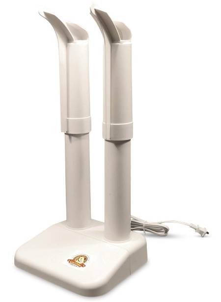

Similarly, the recommendation for wet running shoes was to stuff them with newspapers to absorb the water. So I ran some tests. Running a few miles in heavy rain gets the shoes just as wet as running in knee deep water. I stuffed a pair of wet shoes with newspaper. An hour later, the paper was damp, so I replaced it with dry paper. After repeating several times, the shoes were still wet the next day.

The next test was a boot dryer like this one:
That got the wettest shoes completely dry before the next morning. I put a remote reading thermometer into my shoe dryer earlier today. The temperature inside the shoe is 110 deg F. That's enough to get the relative humidity from a typical 20% to 50% down to less than 10%. The low humidity, along with a continuous flow of air, dries the shoes very nicely. An additional benefit to always having dry shoes is that the shoes last longer.

There is a boundary layer of air next to any surface. Moving air makes the boundary layer thinner, which increases the moisture gradient, which increases the rate of evaporation.
I suggest gentle heat on the phone - about 110 to 120 deg F for a couple of days. Be very careful to not overheat it.
