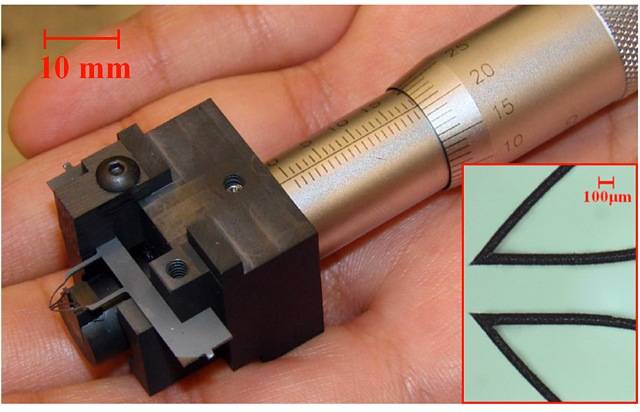

You need a new pair of tweezers. :wink:
http://www.purdue.edu/newsroom/research/2012/120117SavranMicrotweezer.html
<snip>
Heh- no doubt! I work with lightly filed-down #5 Dumonts.
