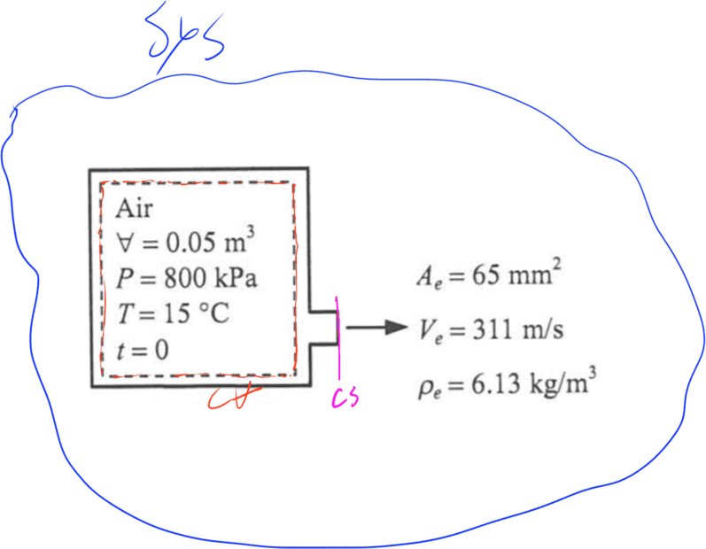

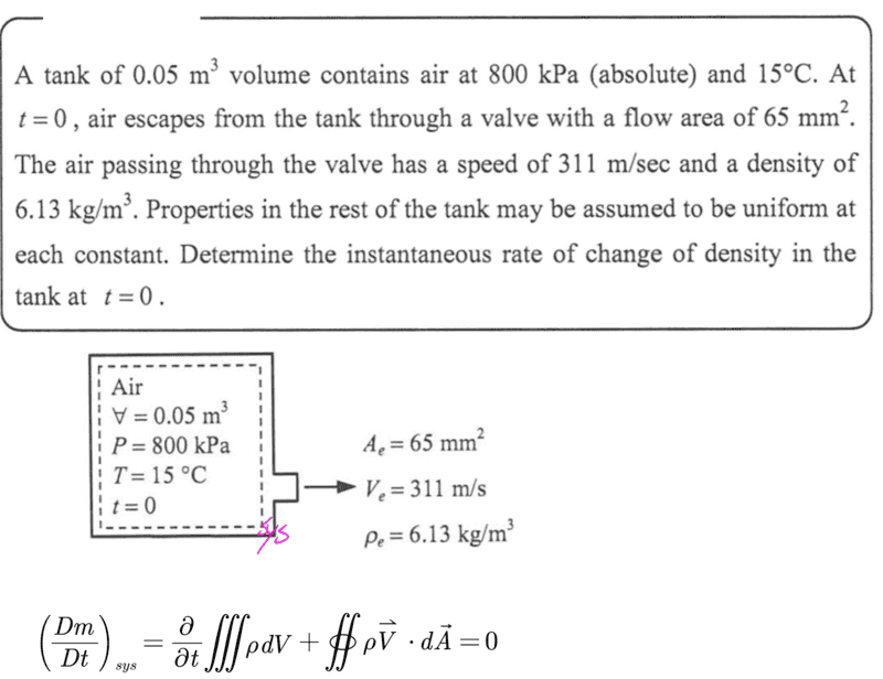

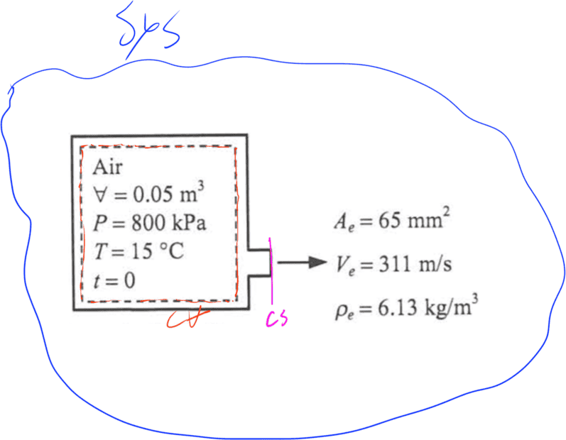

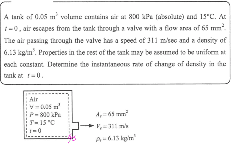

Q: Why is air expelled from the system, yet the system's mass remains unchanged? Isn't mass related to volume?

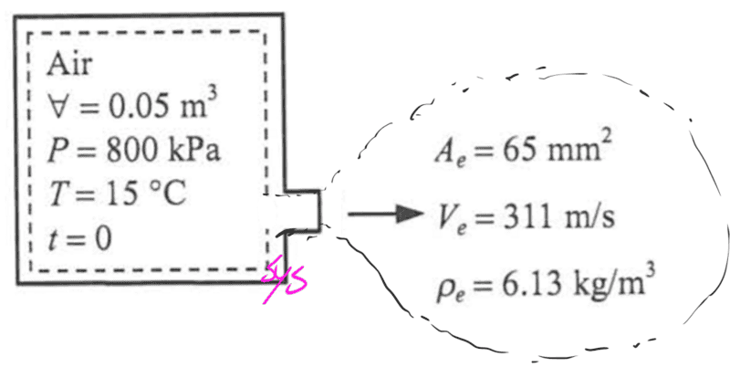

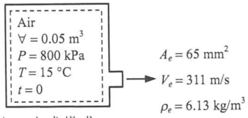

The system includes the expelled air.

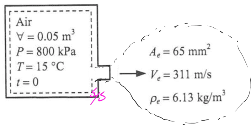

If the system includes air output, how should the cross-section be determined?

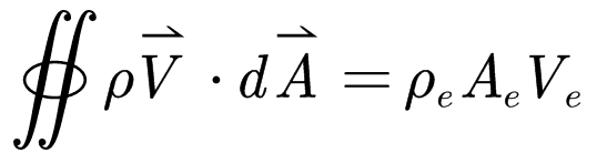

In a closed system, isn't it the case that fluids cannot cross the system boundaries? However, the following equation is indeed correct.
The system is the total mass. It's not changing in time. The tank is the control volume. The portion of the systems mass inside the control volume is changing in time, so you get:
$$ \frac{d}{dt} \int_{cv} \rho ~d V \llap{-} = - \int_{cs} \rho \vec{V} \cdot d \vec{A} $$
which reduces to ( uniformily distributed properties):
$$ \frac{d}{dt} m_{cv} = - \rho_e A_e V_e $$

Could you please explain why you are taking the time derivative of a 4-dimensional volume integral?
I was going to mention there are one too many integral signs. 😬

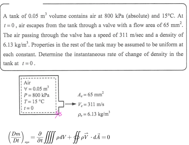

So, my thoughts are as follows, is this correct?
Accidentally typed the wrong characters, it has been corrected.
Yeah, that's how you are to look at it. That first derivative being non-zero is not something you are going to encounter when it comes to mass as the property in R.T.T.
In essence the system is not the control volume, its "the stuff" moving through the control volume, be it mass, momentum , or energy. The "system" enters the control volume, exits the control volume, and/or accumulates within the control volume.
Thank you for the detailed and patient explanation. ^^
