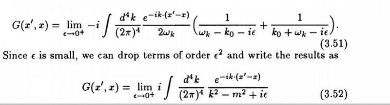

I am wanting to get the expression up to ##O(\epsilon^{2}) ## :
To show that ##\frac{1}{2w_{k}} (\frac{1}{w_{k}-k_{0}-i\epsilon} + \frac{1}{w_{k}+k_{0}-i\epsilon})##
## \frac{1}{k_{v}k^{v} + m^{2} - i\epsilon}##, [2]
where ##w_{k}^{2}=k^{2}+m^{2}##, ##k## the variable, and (this seemed weird for me but it is in my lecture notes) that ##k_{0}=w-w_{k}## in the second term in the sum above and ##k_{0}=w_{k}-w## in the first term in the sum above.
where ##k^{v}k_{v} ## is a summation over 4 dimensions of space time where the relevant metric is the minkowski metric.
My attempts:
So so far I have tried a binomial expansion of ##({w_{k}-k_{0}-i\epsilon}) ^{-1}## and the other term, but of course this brings all terms in the 'numerator' , I don't see how I'll get any ##\epsilon## in the denominator to get something that will look like [2].
and, since this failed, cross multiplying to get a common denominator, but this didn't look promising either... [2]
What is the best way to procceed?
Many thanks

it has not gone from a 4-d integral to a 3-d integral - see attachment - from Hatfield. May differ in signs/factors to original OP/my lec notes , e.g sign convention different in metric , don't know, same idea though..
  • Two equations from a textbook: the Feynman propagator G(x', x) as a limit of a 4-dimensional integral over d^4k/(2π)^4 with e^(-ik·(x'-x)) and two terms with denominators involving ω_k and k_0, followed by the simplified form with k^2 - m^2 + iε in the denominator, numbered 3.51 and 3.52.

Yeh so I tried this:
## \frac{1}{2w_{k}} ( \frac{1}{w_{k}-k_{0}-i\epsilon}+\frac{1}{w_{k}+k_{0}-i\epsilon})##
## \frac{1}{2w_{k}} \frac{2(w_{k} - i\epsilon)}{w_{k}(w_{k}-2i\epsilon)+O(\epsilon^{2})} ##
... didn't look promising to me...

I think you made a mistake.
[itex]\frac{1}{2 \omega_k} [ \frac{1}{\omega_k - k_0 -i \epsilon} + \frac{1}{\omega_k + k_0 - i \epsilon}] = \frac{1}{2 \omega_k}\frac{2(\omega_k - i\epsilon)}{\omega_k^2 - k_0^2 - 2 i \omega_k \epsilon}[/itex]
[itex]= \frac{1- i \epsilon/\omega_k}{\omega_k^2 - k_0^2 - 2 i \omega_k \epsilon}[/itex]
From your definition, [itex]\omega_k^2 = k^2 + m^2[/itex], so [itex]\omega_k^2 - k_0^2 = (k^2 - k_0^2) + m^2[/itex]. So if [itex]k_\mu k^\mu = k^2 - k_0^2[/itex], then it becomes:
[itex]\frac{1- i \epsilon/\omega_k}{k_\mu k^\mu - 2 i \omega_k \epsilon}[/itex]
At this point, since [itex]\epsilon[/itex] is arbitrary, except for being small and positive and real, we can redefine:
[itex]\epsilon = \epsilon'/(2 \omega_k)[/itex]
So your expression becomes:
[itex]\frac{1- i \epsilon'/(2 \omega_k^2)}{k_\mu k^\mu - i \epsilon'}[/itex]
So the issue is the [itex]\epsilon'[/itex] appearing in the numerator. It vanishes in the limit as [itex]\epsilon' \Rightarrow 0[/itex], but it's not of order [itex]\epsilon'^2[/itex]...
I wasn't familiar with Hatfield, so I took a look. I'm not impressed -- too many fudges and typos.
Hatfield starts from a 3D Fourier expansion, then puts in time-ordering ##\theta## functions, expresses the latter as an integral in eq(3.49), then goes to a 4D expression for ##G(x',x)##. But there seems to a serious typo in eq(3.50) where an integral over ##\omega## is absent.
Anyway, as demonstrated by @stevendaryl, Hatfield's explanation appealing to "##O(\epsilon^2)##" is yet another fudge. Better treatments start from a 4D integral involving ##\delta^{(4)}(p^2-m^2)## and use a ##p_0## contour integration to get a 3D integral.
