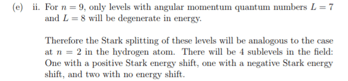

For e ii) The answer is
242122
Why are there only 4 sublevels?

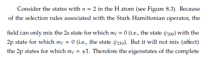

We haven't learned about degenerate perturbation theory, the only thing mention in lecture is
242123
which I don't understand so I only memorize the good eigenfunctions for n=2. Could you explain why there are still only 4 sublevels for n=7 and 8?

He is talking about the n=9 Rydberg states only. Within this are the allowed states L=0,1,...,8 each with multiplicity 2L+1. Only the highest angular momentum states are "far enough away" from the "nucleus/inner electron complex" to be approximately degenerate. So we are down to L=7,8. So how will this subset be affected by perturbation?

There are two states you know don't connect (create any off diagonal elements). What are they?
