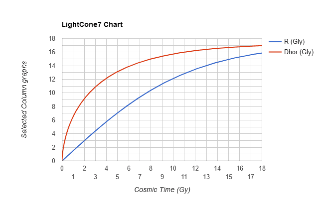

Jorrie said:
The Hubble diameter is about 2.7x10^26m, which defines the present cosmic event horizon.
This is tangential to the subject matter, but isn't the present-epoch event horizon farther than the Hubble radius? Shouldn't they coincide with one another only in de Sitter universes?
The terms during the pre-de Sitter epoch are a tad confusing. The Hubble radius is the present proper distance where the recession rate equals 'c', so no particle emitted there now can ever reach us, because it will forever be taken away from us.
The cosmic event horizon is the farthest (present) proper distance that a particle emitted by us now can ever reach, because again, the particle is forever taken away from us by the expansion (as I understand things).
Mike McCulloch referred to the Hubble diameter in his paper https://arxiv.org/abs/1302.2775 (just below equation (1)), not the latter.
I don't think you have it right. It could never reach us only if we were living in a de Sitter universe. Since we aren't, and the Hubble radius is increasing, a particle emitted at the H_r now, will tomorrow find itself within the radius and start making its approach - which means it can be observed, and that by definition it was within the event horizon at emission.
Even your own calculator gives different values for the H_r and the horizon.
Whether we're talking about a signal emitted by us or received by us doesn't matter, since the situation is symmetrical.
But I don't think what I wrote contradicts that. The Hubble radius increased faster then one lyr/yr ("c") only when the metric expansion was decelerating. If our models and data are correct, it is today 14.4 Glyr away and increasing at a rate somewhat below "c", so it does not catch up with photons released beyond that, where proper distances increase at greater than "c".
However, a photon that we send today can reach a galaxy that is presently ~16.5 Glyr from us - our communication horizon. I think what McCulloch referred to is the effect of the Unruh radiation from the Hubble horizon on us. IMO, the symmetry that you mentioned only means that an observer presently at our Hubble radius will find the same values than what we do, but that's a different 'perspective', so to speak.
(once again, I have nothing to say about the papers in the OP, so if you think this is clogging the discussion we can take it to the conversation feature)
But it doesn't have to increase at rate higher than c to catch up with these photons, because they are not comoving with the Hubble flow.
The net velocity of a photon emitted at H_r (towards the observer) is 0 (recession velocity + photon velocity), so H_r needs only grow at any rate higher than 0 to be able to catch up with and overtake photons released at itself.
The rate of growth of H_r determines how far beyond it a photon can be emitted and still be caught up with, i.e. the distance to the event horizon, which is why the difference between these two distances diminishes as we approach de Sitter expansion.
This should be visible on the third (conformal time) light cone graph in Davis' paper - it shows that the event horizon is just the past light cone of an observer at infinite future, and that it encompasses events currently beyond H_r.
I don't think there's any kind of a different perspective here. After all, if you look at your second paragraph above, it suggests that a galaxy beyond H_r can receive our signals - but your first paragraph contradicts that, since it suggests those photons are already beyond H_r, and will never be caught up with by the growing Hubble radius.
I believe @bapowell wrote about this in his Insight on cosmological horizons. Maybe he can back me up (or set me straight).
Yes, you are right! The Hubble radius is not an event horizon. Sorry for the confusion. o:)
A photon emitted precisely at Hr "hangs there" for a period and then Hr increases beyond its coordinate, so it starts to make headway toward us. So I guess that the horizon McCulloch should use for the (hypothetical?) Unruh radiation is the cosmic horizon at 16.5 Glyr.
Likes Greg Bernhardt
