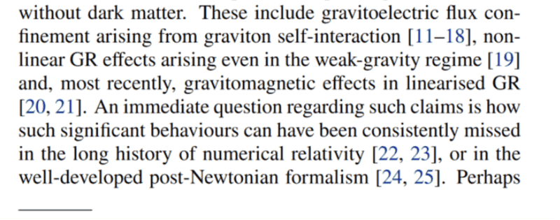

Printed journal page text arguing that claimed relativistic explanations of galaxy rotation curves have been missed by numerical relativity and post-Newtonian work, citing references 11 to 25.

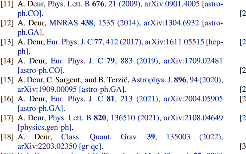

Reference list, entries [11] to [18], of papers by A. Deur in journals such as Phys. Lett. B, MNRAS, Eur. Phys. J. C, Class. Quant. Grav. and Astrophys. J., with arXiv numbers.
the question is why if Deur is correct why has his results been missed by numerical general relativity and other approximations by highly qualified GR experts

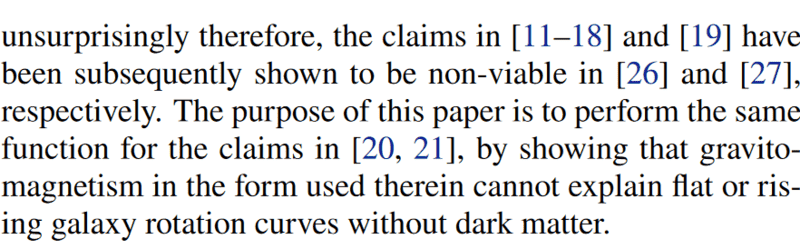

Printed paragraph of academic text ending a paper's introduction: it says earlier claims were shown non-viable and that the paper will show gravitomagnetism cannot explain flat or rising galaxy rotation curves without dark matter.
Reference list excerpt: [26] W. E. V. Barker, M. P. Hobson, and A. N. Lasenby, (2020), manuscript in preparation. [27] M. Korzynski, J. Phys. A 40, 7087 (2007).

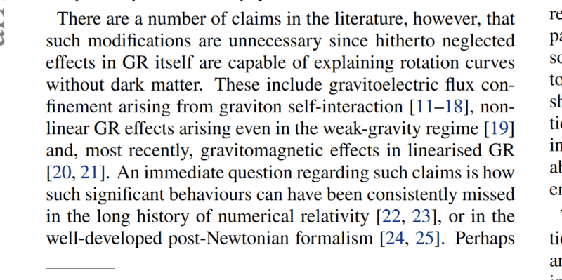

Again,
Scanned page of printed academic text discussing gravitoelectric flux confinement, non-linear GR effects and gravitomagnetic effects in linearised GR as alternatives to dark matter, with citations [11-25].
Deur's claims are highly implausible on the fact that despite over the long history of GR, including use of super computers, they have found nothing to support Deur's conclusions.
numerical relativity is analyzing GR via super computers by highly qualified experts in multiple specialties over decades, which did not find any evidence of Deur's self-interactions strong enough to explain or replace dark matter
Can you explain why GR experts have missed such important effects after decades of study as identified by Deur, and why numerical relativity has over decades completely missed such important effects Deur has claimed? (or others such as nonlinear effects of GR or GEM?)

kodama said:
Again,
