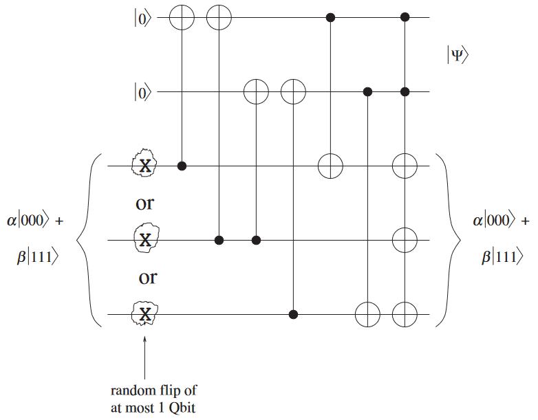

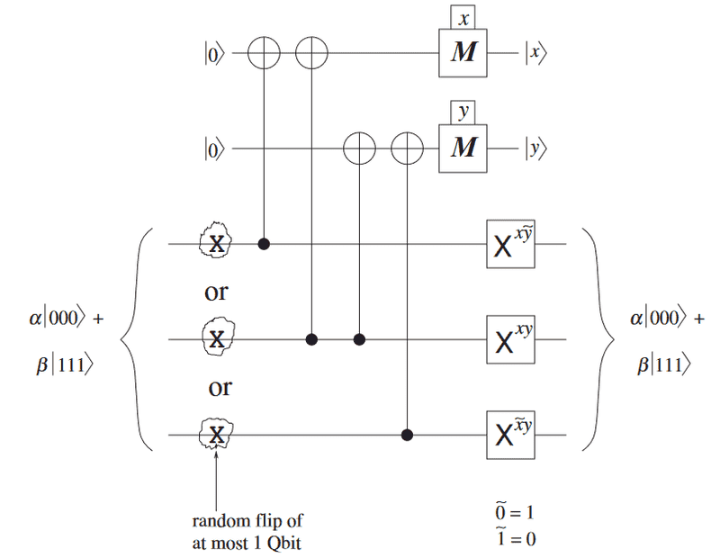

In the circuit model, error correction works by first making measurements, and then applying corrections using different unitary gates based on the outcomes of the measurements. And measurements are irreversible.
But why should this irreversibility be necessary? Some of the errors caused by decoherence are irrevesible and increase the entropy, so another irreversible process is needed to decrease the entropy again.
But is this argument really convincing? To play devils advocate, the measurements and their results could be treated in MWI style, so that all possible measurement outcomes and their corresponding corrections would exist in a superposition. At the end of the computation, we still have to read out the result by a measurement, but that is fine as long as we only read out the result we are interested in, and not also many anicillary results corresponding in some way to all those intermediary measurements in superposition. I don't know at the moment whether it is necessary to read out many ancillary results (when using this MWI style error correction), but it seems like an answerable question to me.
Likes vanhees71

I now think that this actually works (i.e. that you don't need to measure any ancillary results). Those ancillary qubits simply serve as a reservoir into which the entropy can be pushed, allowing the main computation to get rid of the entropy increase caused by decoherence. Or to put it another way, those ancillary qubit serve as a reservoir of order to be used up during the quantum computation.
In conclusion, error correction must only get rid of the entropy, and being irreversible is not the only way to achieve this.

Let's say we start with a qubit in a pure state (0 entropy), and we are on a certain branch of the many-worlds. Then an error occurs due to decoherence. That is because decoherence causes our branch to split into multiple branches, and each new branch lost some information which is now on the other new branches. The qubit now has higher entropy since it is in a mixed state (of all the new branches).
Then, for error correction, are we actually trying to merge back all (or as many of) the new branches into one low-entropy branch that would contain all (or as much as possible) information from the initial branch?

Measurements are typically irreversible processes, and they are part of the "standard" error correction schemes.
PeterDonis said:
I don't see how that would apply in the case of error correction, since no "larger system" is involved, it's just the same set of quantum logic gates.
You always have the ancillas, which are already a larger system. And if you do an actual measurement on an ancilla, then an even larger system gets involved.
(The "set of quantum logical gates" are not the (sub)system, only the qubits are.)
Do the error correction operations involve the ancillas? It didn't appear that way from your previous description; it appeared that those operations only operate on the qubits that are intended to store the desired information.
As you described it, measurements are used to tell which error correction operation to apply, but the actual error correction operations are unitary. If that is the case, the error correction operations can't change entropy, since no unitary operation can.
Indeed, this is how the "standard" error correction schemes work.
The measurement operation on the ancilla qubit is part of the "standard" error correction scheme. And this operation is not unitary. And the ancilla bit gets entangled with the main qubits before the measurement operation, so ignoring it completely doesn't work either.
So they are unitary? But:
So they are not unitary?

  • #31
PeterDonis said:
So they are unitary? But:So they are not unitary?
I'm confused.
This is why I keep asking for a reference.
My understanding is that error detection is not unitary (involves measurement) but error correction is. Of course one could put both detection and correction under the same umbrella of "error correction".
