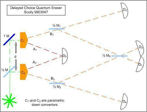

The Quantum Erasure experiment by Scully et al http://arxiv.org/abs/quant-ph/9903047 appears to have generated more questions than it has settled. Please look at attached figure below, which I believe is isomorphic to their quantum erasure experiment Fig. 2. Photons A and B are entangled. Path A << Path B and registration on D1, D2, D3, and D4 is significantly delayed after that of D0.
The paper provides 4 patterns obtained on D0, each isolated by coincidence counting with registrations on D1, D2, D3, and D4. D0|D1 (pattern on D0 due to D1 coincidence counting) is a fringe. D0|D2 is an anti-fringe. D0|(D1+D2) is a Gaussian with mean 0. D0|D3 is a Gaussian with mean +d/2 where d is the distance between the two slits. D0|D4 is a Gaussian with mean -d/2.
Quesiton 1: Would the coincidence patterns change if Path A >> Path B ?
Question 2: what is the total pattern on D0, i.e. D0|(D1+D2+D3+D4), when the coincidence registrations are completely ignored.
Is D0|(D1+D2+D3+D4) = D0|(D1+D2) + D0|D3 + D0|D4 ?
If the total pattern on D0 is the sum of the other 4 patterns (i.e. Question 2 is positive), then I think it implies that D0 is NOT a Gaussian because d is not 0. (This will lead to contradictions :confused: )
I am sure this issue has been discussed before, and there is something fundamental that I am missing, but I could not find it here or elsewhere. Your insight will be highly appreciated, and thanks in advance.
Zekise

Let me put the question in another way - Assume R0 is the total pattern on D0. What is the graph for R0? Is R0 independent of the setup on the delayed path B?
R0 should be independent of path B. If not, we can for example remove M1 and M2, and pass a message from M1, M2 to D0. This will violate locality if path B >> path A.
How can R0 be independent of the B setup, but at the same time delayed registrations on D1, D2, D3, and D4 can decompose R0 into components that are correlated with the B setup?
I must be missing some fundamental reality about this experiment. Pls. help. Thanks :smile:

I don't know how to actually do the math to derive the answers here, but just based on the principle that entanglement does not allow signalling faster than light, it seems clear that the total pattern at D0 must be a gaussian, because it would certainly be a gaussian if you removed the beam-splitters so that all the idler photons ended up at D3 or D4 and had their which-path information preserved, so if the total pattern at D0 would change with the beam-splitters in place, that would give you knowledge of whether a distant experimenter had removed them or not.
Why do you think that D0 being the sum of the other 4 patterns implies it is not gaussian? The sum of D1 and D2 would be a gaussian since the peaks of one line up with the valleys of the other, and D3 and D4 are already gaussian.
edit: OK, I think I see your question, I didn't catch the part about D0|D3 and D0|D4 having different means. I guess it might be that the total pattern would actually be the "double hump" pattern that's the sum of two gaussians with sufficiently different means (if the difference is small I believe you still get a single hump, but the curve may not qualify as 'gaussian' any more), like in the double-slit experiment when you measure which slit each particle went through. But in that case, presumably the sum of D0|D1 and D0|D2 would also have to be the same pattern.
JesseM - thanks for your reply. I am studying it. But another thing comes to mind.
What if D0|D1 fringe and D0|D2 anti-fringe are actually offset by d from one another? That is D0|(D1+D2) is a double-hump Gaussian (which is actually a non-Gaussian, so let's call it a semi-Gaussian) - so that it coincides with D0|D3 and D0|D4, exactly? Therefore, R0 is just one big double-humped semi-Gaussian, no matter what the setup is at delayed interferometer B?
But this still does not resolve the mystery that after registration of photon A, how can photon B, going through beamsplitters, "find the right detector D1, ..., D4", so that a fringe and anti-fringe emerges from coincidence selection of the total pattern R0?

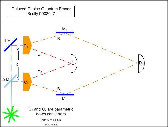

a4) But the momentum is complementary to the WWI. So how can this reveal both momentum and WWI at the same time? The D5 detector here acts as an erasure and should not give us WWI. Am I missing something here? Or is it the way it is drawn?
a4.2) Pls. look at diagram 2 enclosed. This shows DIB being replaced by D5, and M1, M2 being replaced by full mirrors. Path B >> Path A. D0 and D5 are both erasures and there is no WWI at D0 or D5. I understand you are saying that in this situation, we will still get a DHG on D0 consisting of a fringe and anti-fringe (and no which-way gaussians).
But what gives rise to the anti-fringe? There is no symmetry here like in diagram 1. However, we must get anti-fringes, or D0 will not be invariant. So where do the anti-fringes come from? Is it that half the time we get fringe, and the other half anti-fringe randomly? Then what accounts for the phase shift in one of the wavefunctions necessary for the anti-fringe? And why don't we get anti-fringes in a standard non-entangled double slit experiment?
[Aside: Is this symmetric interference the preferred way for the wavefunction to collapse in diagram 2 and is this what is meant by einselection (or superselection?) where certain states of the system is preferred and emerges out of the setting to create the classical world?]
a7) Back in diagram 1, we turn that into a Mach-Zehnder interferometer. All we have to do is tweak M1 or M2. What will happen is all pB going to Me, due to interference registered by pA, will end up in D1 and none will end up in D2 (or vice versa). Therefore there can't be any anti-fringes, and D0 will cease to be DHG. And coincidence correlation will show the fringe, but no anti-fringe. What gives?

WWI == which-way information (i.e. did pB come from C1 or C2).
Note D5 in diagram 2, which like D0 is a CCD array - equivalent to a screen, when it registers a photon, it only obtains momentum (statistically when the fringe emerges, wavelength being momentum). The position on the array D5 signifies the momentum, and not WWI, because WWI is erased. If WWI had not been erased (by D0 let's say), then the position on D5 could signify WWI (i.e. which hump did pB register).
The way I understand diagram 2, is that since WWI is lost, interference will arise in the form of the fringe and anti-fringe. So both D0 and D5 will identically show the usual double hump gaussian, and will be invariant, and will not have any gaussian component (like the old D3 and D4 used to provide). That is, D5 is purely made of a fringe and an anti-fringe (the old D1 and D2) and is a DHG.
However, we cannot descipher the fringes, because our interferometer is not providing us the coincidences to distinguish fringe from anti-fringe. Its as if you performed the Scully Erasure experiment, and then you deleted the file containing the D1 and D2 registrations. So you will lose the ability to decipher the fringes.
The real question (a4) I think is how does anti-fringe arise in this case where there is no symmetry? As you recall, the anti-fringe must arise to make sure that D0 remains DHG and invariant.
