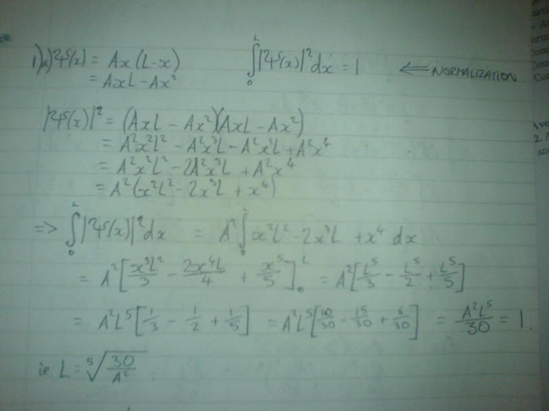

Hi people,
I'm struggling with my quantum mechanics homework - I've included links to photographs of my attempts at solutions, but i know they are wrong because I am given what the answers are supposed to be. Can somebody help me spot where I am going wrong? I don't have a keyboard key for psi(x) so i'll use Y(x) for wavefunctions. Here is the question:
My particle, described by the wavefunction Y(x) = Ax(L-x) is confined to a region 0<x<L.
A is a constant.
a) Normalize the wavefunction to unity.
b) Compute the average value of position <x> , <x^2> , <p> and <p^2>.
Here is my solution to part a).
Have i done what is being asked of me, ie. square the wavefunction, and set the integral of that, within the limits of x, equal to 1??
http://i52.photobucket.com/albums/g33/long_john_cider/normalization.jpg

Well, first of all, you almost did a) correctly: you calculated the integral of psi^2 (actually, psi* psi) and set it to one. But then somehow you missed the point of the exercise: L is the given width of the "box" your particle is in, while A is the normalisation factor. So the idea is to solve the expression you have for A.
Then you will get, for example, for <x> a very nice answer. It's instructive to try and guess what it should be in advance, based on your physical intuition (sketch the wavefunction, where do you think will be the most probable place for the particle?)
I'm not sure about your <x^2>, it looks unfamiliar. Maybe if you express it just in terms of L (by rewriting A, using a)) you will find the correct answer? I think you should have something withan L^5, not L^2, there.
aah thank you CompuChip, my answer for <x> turns out to be L/2 (which seems to make sense), since my normalization constant is A^2 = 30/(L^5).

Very well, so you can take Y(x) = sqrt[30]/L^(5/2) x (L - x)
and calculate <x^2>.
