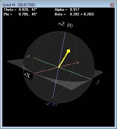

However, there are other criteria that must be maintained. As those familiar with quantum computing know, all of this can be conceptualized as a Bloch sphere (with a corresponding Bloch vector).
These additional criteria require the introduction of Theta and Phi (two angles in radians). And that's also where the problem rears it's head yet again. I can solve for Theta and Phi from Alpha and Beta so long as Alpha is "Real". Theta and Phi can be thought of as polar coordinates, with the limits of...

Shucks, I'll even provide an example of the problem. Let's say we start out with a qubit in the state...
[tex]\alpha = .959 + 0i \\<br /> \beta = .179 + .221i[/tex]
We see that we start out with a "Real" Alpha. Now, let's shove it through a NOT gate. After that, the qubit looks like (set #1)...
[tex]\alpha = .179 + .221i \\<br /> \beta = .959 + 0i[/tex]
However, in the spirit of keeping Alpha "Real", it should look like (set #2)...
[tex]\alpha = .284 + 0i \\<br /> \beta = .603 - 745i[/tex]
It can be verified that...
[tex].284^2 = .179^2 + .221^2[/tex]
... and that ...
[tex].959^2 = .603^2 + .745^2[/tex]
So, it's clear that my equalities are holding.
I also have software that verifies that the Bloch vector isn't changed from set #1 to set #2. However, I don't have the algorithms to transition from set #1 to set #2.
