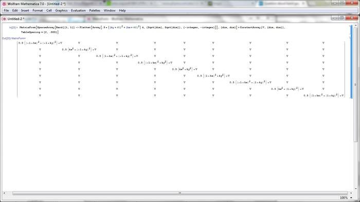

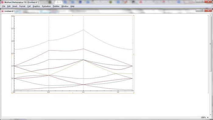

I'm studying a two dimensional lattice with delta functions at the lattice points. When I diagonalized the hamiltonian I noticed that if I kept the dimension of my matrix less than 5 I would get band gaps at all the BZ boundaries. However, if I increased my matrix to a dimension 5 or higher, some of the bands never got a band gap at certain boundaries despite a huge potential! The picture shows the first 5 energy bands (used dimension 9 matrix because it is more symmetric along the diagonal) for a .5 potential in atomic units.
So I was trying to figure out why this was happening, and I thought that perhaps it's because the roots of 5th order polynomials and higher can't be expressed in terms of radicals. This is a stretch, but maybe the potential-dependent separation between bands at the BZ boundaries is in part a result of having radicals in the solution to the eigenvalues problem. This doesn't happen when using a 1D lattice however, so why would radicals only matter in 2D?
My other guess is that it has something to do with symmetry breaking. Perhaps the symmetry isn't broken at these points for some reason. I wouldn't know how to back this up however. Could anyone tell me why there are no band gaps at some locations for a hamiltonian 5x5 and higher?

Also, the potential does has an influence on the spectrum, but only at certain points. You can see from the picture I posted that there are bands gaps, just not at every symmetry point.

Sure. Here is an example 9x9 matrix. The potential V can be any value. Units are atomic.

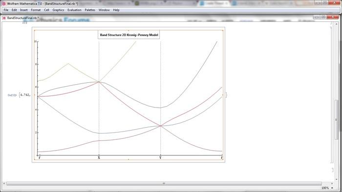

Yeah the graph is skewed for some reason. Here is a better version.
Ok, so I am starting to get an idea how to qualitatively interpret your results: Easiest is the situation V=0. E.g. at point Y,
the following states are degenerate (degenerate levels ordered according to energy): [(-1,0), (0,0),(0,-1),(-1,1)], [(1,0),(0,1),(1,-1),(-1,1)],(1,1) where the brakets are (Kx,Ky). Now using degenerate perturbation theory, each of the 4 blocks is split into a 3+1 states where the single state is shifted upwards, because a nxn matrix filled with ones, has one eigenvalue n and n-1 eigenvalues 0. The same can be done for the other high symmetry points (it would be more standard to relabel Y to M).
For larger values of V, I would expect only some 2 fold degeneracies to remain. The next step would be to label the zeroth order states at the high symmetry points according to the symmetry of the little group.

It's starting to make sense! I played around with some random matrices to confirm what you said here. If the matrix has all the same elements along the diagonal, i.e. all degenerate, and the same constant for all the off-diagonals, then only one band is affected by the off-diagonals. If the off-diagonals are positive, then this will be the top band. If they are negative, this will be the smallest band. I tried changing my potential to a negative value, and indeed the lowest band separated from the rest instead of the top band. I'm not sure how this relates to degenerate perturbation theory, but maybe it will make more sense once I review my notes on that topic.
I meant that the diagonal elements can be written as ##(Kx+kx)^2+(Ky+ky)^2##. At the gamma point, kx=ky=0. I grouped degenerate states with square brakets.
The eigenstate corresponding to the eigenvalue n of an nxn matrix of ones is (1 1 1 ...1). All what is orthogonal corresponds to eigenvalue 0.
