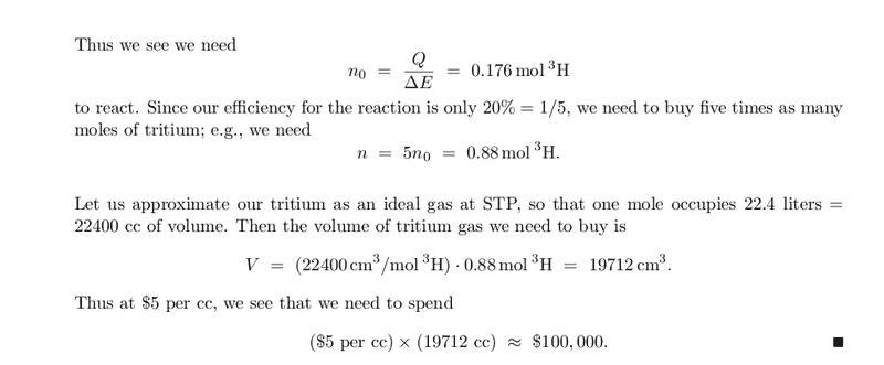

This is question 1-9 from French's Special Relativity
The equations are shown in my attempt at a solution below
The answer in the back of the book states it should cost about $50,000. Where did I make an error here? Or is the answer in the back of the book in error?
I apologise if this is improper to post screenshots instead of the actual text. I wrote this in LaTeX but with a bunch of macros I have defined, and can't remember how to do some of the writing in plain LaTeX to post the text here.
Is hydrogen gas monatomic or diatomic?
LOL, you're right. I know standard hydrogen occurs as a diatomic molecule but for some reason didn't connect the dots on tritium gas being diatomic too. Thanks!
