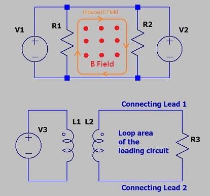

A former colleague asked me a simple question about Faraday's law. As shown below, the configuration is just a circular conductor and a changing B field, and then tried to measure the voltage across the diameter. But I am not sure what the answer is?
Any help would be greatly appreciated.
Nevertheless, what are your thoughts, uncertainties, etc., about it? Then people here can address them directly, and try to clear up any errors in your thinking, instead of simply giving you the answer (which is frowned upon here).
You nowhere say exactly how the B field is changing in time (uniformly?).
When you have a changing field like this it is no longer a "circuits' problem and you need to consider the fields explicitly. The reading on the voltmeter will depend upon the exact path of the wires, not just their topology. Are you assuming perfect symmetry? So make an analysis.
This is of course Walter Lewin's famous headscratcher.
Thanks for your reply.
My idea is that from the front view, there are two loops connected to the voltmeter, the EMF induced on the right side seems to be +0.5V, and the EMF induced on the left side seems to be -0.5V. There seems to be a contradiction, maybe there is no contradiction at all. I think it is possible to add two values. So the answer should be that the maximum chance is 0V.
Is my inference correct?

Of course it depends on the geometry of the wires connected to the volt meter. You don't have a voltage here but an EMF, because the electric field is not conservative since ##\vec{\nabla} \times \vec{E}=-\partial_t \vec{B} \neq 0##. The volt meter in fact measures a (usually very small) current going through it. So you measure the EMF as calculated along the wires connecting the volt meter.
So the easy way for me to consider the problem is to realize (as @vanhees71 points out ) that the voltmeter in fact measures the current through it. Current is absolutely conserved and the net current through the meter in the symmetric case is the sum of two equal and opposite currents if one looks at the two smaller loops. So zero is the reading. Any asymmetry will likely produce a nonzero reading, but it will not properly be called a "Voltage" in the usual Kirchhof sense.

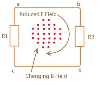

After rethinking this issue, I think that there is no paradox.
We should not treat a and b are exactly same, even if there is no voltage drop due to Ohm's law, there does exist an induced electric field between them, so they are indeed two different points.
As long as we define the Electromotive force (EMF) and PD (potential difference) as follows,
Electromotive force, ##~EMF_{ab} =−\int_a^b E \cdot dl ##
Potential difference, ##~PD_{ab} = \int_a^b E \cdot dl ##
and put the EMF (created by the induced electric field) into the equations, the correct calculation result can be obtained.
For example, we can easily prove that if the resistance of each point of the circular conductor is the same, there is indeed no potential difference along the circumference of the conductor.
Total length ## ~ L=\sum L_i ##
Total EMF ## ~ \mathcal E=\sum \mathcal E_i=\sum C_1L_i##
Total Resistance ## ~R= \sum R_i= \sum C_2L_i ##
where ## ~C_1## and ## C_2 ~## are constants
For any arc length ##~ L_i ~## on the circumference, the actual potential difference should be : -
$$ \mathcal E_i - \frac {\sum \mathcal E_i} {\sum R_i} R_i$$
$$ C_1 Li - \frac {\sum C_1L_i} { \sum C_2L_i } ~ C_2L_i ~~ = ~ C_1 Li - \frac {C_1} { C_2 } ~ C_2L_i =~0 $$

Sigh, well, I forgot that this imprecision is in this text. Please bear in mind that there is NO POTENTIAL in this case, because (in SI units)
$$\vec{\nabla} \times \vec{E}=-\partial_t \vec{B} \neq 0$$
and that's the reason why the meters in Lewin's example show different readings. What the (idealized) volt meter measures is the EMF (NOT VOLTAGE!) along the wires. Note that it's a CLOSED line integral:
$$\mathcal{E}=\int_{\text{wires}} \mathrm{d} \vec{r} \cdot \vec{E}=-\dot{\Phi}_{\vec{B}},$$
where ##\Phi_{\vec{B}}## is the magnetic flux through an arbitrary surface with the wires making its boundary (assuming that the wires are at rest).
@vanhees71 the scalar potential is defined even in the case of ##\nabla\times\vec{E}\neq\vec{0}##, simply by the solution to the wave equation (in the lorentz gauge)$$\nabla^2 V-\frac{1}{c^2}\frac{\partial^2 V}{\partial t^2}=-\frac{\rho}{\epsilon_0}$$ but of course as you notice the voltmeter doesn't measure that (it usually does but not in this weird setup).

I would like to express my views on the issue of non-conservative electric fields and potential differences.
Although the induced electric field is non-conservative, but for the fixed path and direction in the electric field, such as R1 and R2 shown in the figure below, there can indeed be a potential difference, because their voltage will respectively vary with their resistance, and they consume energy. But, of course, the placement and direction of the two voltmeters and their leads may affect the measured value.
Consider again the transformer shown in the figure, the secondary output voltage is also produced by the non-conservative electric field induced by changing magnetic field, therefore, its corresponding line integral of the electric field should only be along the path of the secondary coiled wire. If the line integral follows other paths, of course there may be different results.
In addition, We can see that the placement and direction of the secondary external output circuit loop has no (or extremely little) impact on the output voltage. The reason is obvious, because for the same magnetic flux , it only has one turn, but the number of turns inside the transformer is usually much larger than one turn.
