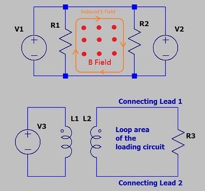

alan123hk said:
I would like to express my views on the issue of non-conservative electric fields and potential differences.
Although the induced electric field is non-conservative, but for the fixed path and direction in the electric field, such as R1 and R2 shown in the figure below, there can indeed be a potential difference, because their voltage will respectively vary with their resistance, and they consume energy. But, of course, the placement and direction of the two voltmeters and their leads may affect the measured value.
Consider again the transformer shown in the figure, the secondary output voltage is also produced by the non-conservative electric field induced by changing magnetic field, therefore, its corresponding line integral of the electric field should only be along the path of the secondary coiled wire. If the line integral follows other paths, of course there may be different results.
In addition, We can see that the placement and direction of the secondary external output circuit loop has no (or extremely little) impact on the output voltage. The reason is obvious, because for the same magnetic flux , it only has one turn, but the number of turns inside the transformer is usually much larger than one turn.
This language is, from my experience, precisely what confuses students. If there is no potential, how can there be a potential difference? What we discuss here are precisely no potential differences but the non-vanishing "electromotive forces" (where "force" in this context is not force in the Newtonian sense but means an energy-like quantity). It's precisely NOT a potential difference, because it's the line integral of a vector field along a CLOSED loop. If the vector field were conservative, i.e., would have a potential, this EMF would be 0. Then and only then is the potential difference given by line integrals along an arbitrary open path connecting the two points where the potential difference is taken, and then and only then is this potential difference independent of the path chosen to connect the two points.

The inductor and the secondary coil of a transformer that delivers the "voltage" to a resistive load is a problem that involves a changing magnetic field, but upon looking at this problem a few times over the last couple of years, I'm starting to believe more and more that what is measured at the output terminals is indeed a potential difference which is just the integral of the electrostatic field. The induced electric field ## E_{induced} ## is most often contained within the voltage source. Whether the EMF is generated by a changing magnetic field, or is the result of a battery, or solar cell, the net result is that it behaves as if it were an electrostatic source, e.g. like that of a Van de Graaff generator. ## \\ ##
For the inductor and transformer,we must have that ## E_{total} \approx 0 ## inside the coil, so that an electrostatic ## E_s=-E_{induced} ## must be present, where ## E_{total}=E_{induced}+E_s ##. Since the electrostatic field is conservative, i.e. ## \oint E_s \cdot ds =0 ## for any and all closed paths, the integral ## V=\int E_s \cdot ds ## is well defined outside the device, (it's absolute value is equal to ## \mathcal{E}=\int E_{induced} \cdot ds ## inside the device), and is the potential difference.
For the case of the battery, the EMF is not from a changing magnetic field, but rather a voltage created by a chemical reaction, but the same conservative electrostatic field rules apply, external to the device.
It is this electrostatic field, i.e. ## \int E_s \cdot ds ## that is measured by a voltmeter or oscilloscope, which can be modeled as a large resistor, with a small current passing through it. The voltage is the product of the resistance and the current.
Taking Professor Lewin's "paradox" into account, it would appear that with an oscilloscope or voltmeter we could get slightly different readings from an inductor type voltage source, depending on where we put the lead wires, but for a toroidal type transformer or similar geometry, the lead wires generally wouldn't encompass a region of changing magnetic flux, and the readings would be unambiguous. These readings, with minimal induced electric field component, would be readings of the electrostatic field, i.e. ## V=\int E_s \cdot ds ## which is also equal in absolute value to the EMF ## \mathcal{E}= \int E_{induced} \cdot ds ## inside the component.
I understand what you mean, according to definition and theory, it is true.
Therefore, I think we should probably not say that the output of the transformer is a potential difference.
For example, It is not quite correct to say "..potential difference induced across the secondary winding.." in this education material https://phys.libretexts.org/Bookshelves/University_Physics/Book:_University_Physics_(OpenStax)/Map:_University_Physics_II_-_Thermodynamics_Electricity_and_Magnetism_(OpenStax)/15:_Alternating-Current_Circuits/15.07:_Transformers
Even if the load is far away from the transformer and will not be interfered by the electromagnetic field of the transformer, it is always the one turn of the output winding of the transformer, and the close line integral of this turn along with the output winding is still not zero.
In addition, all AC circuit should not have a potential difference, because it involves an varying electromagnetic field. So many people like to say "AC potential difference" is not very correct.
I am not arguing anything about the definition and theory, I just think that they may be applying an equivalent model to solve practical problem under certain conditions, the model may not be perfect, but for them, this method is very useful and reasonable. :smile:

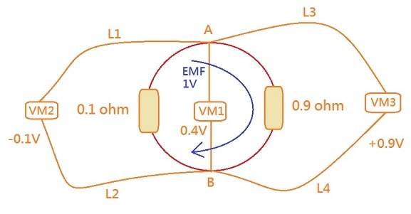

A gentleman made a short film to explain Lewin's paradox.
This short film is titled "Lewin's Paradox Explanation: Kirchhoff's Voltage Law (kvl) doesn't work on DC either!", But of course he didn't mean that "Kirchhoff's Voltage Law (kvl) doesn't work on DC either". Another gentleman replied that he had the same idea, but according to his narrative, the professor said that he didn't understand it, so obviously the professor did not agrees with this method of explanation, but I think this method of explanation does not seem to be completely nonsense, so I really don’t know.
The two resistors in the configuration are different. Meanwhile, the voltmeters are attached to completely different points in the circuit. IMO, this video is poor physics, and is not on par with that of Professor Lewin's.
The circuit analysis of this is kind of simple, and most of the current flow is in the inner loop. With the different resistors, the connection points to the outer loop are not at the same voltage. Thereby, the voltmeters in the outer loop will also read differently.
Edit: If you assume the internal resistance of the batteries is on the order of one ohm or less,( a google says Rinternal≈80mΩ), the circuit analysis is rather simple: The inner loop functions virtually independent of the outer loop. You get a 4.5 volt drop across the 150 ohm resistor, and a 1.5 voltage drop across the 47 ohm resistor. Picking a point as the 0 volt ground, you can assign voltages to the contact points of the outer loop. The voltmeter readings are just as expected. This is all very basic physics=perhaps I shouldn't call it poor physics,(the circuit analysis is somewhat interesting), but it seems to lack relevance to Professor Lewin's concepts. Edit 2: Perhaps it was made as kind of a joke=I'm not sure.
Edit 3: It took me a while, but I think I see what the fellow is trying to show with his video: If we do have EMF's in the line, represented by batteries, we will of course get different voltages on the two voltmeters if the resistors are different. Futhermore the batteries are all placed to be in the same direction as the EMF's in Professor Lewin's video. Notice also the opposite polarity on the voltmeters, as Professor Lewin also got. It's really a very clever video, but he doesn't expound much on it=it takes a little thinking to see the analogies. Thank you @alan123hk for sharing. :)
It seems that he spent a lot of time making the circuit and the video, but what he wants to express is actually very simple.
He wants to point out that even assuming that the voltage between the upper and lower points of the middle structure is a constant value, but because of the connecting wires of the two voltmeters will have an induced voltage generated by the changing magnetic field, so the readings of the two voltmeters on the left and right will be different. Note that the circuit he showed has two batteries at the top and bottom. These batteries are used to simulate the voltage induced on the wires of the two voltmeters.
I believe the theory behind his idea also seems reasonable. Please note that the two voltmeters and their connecting wires do form a closed loop or two loops, respectively, and there is a magnetic field change in the middle of this closed loop. According to Faraday's Law, there is an induced voltage on this loop, and, of course, the final readings of the two voltmeters are produced by combining the voltage generated by the central structure.
In any case, I admire his passion for science, and his video is also helpful for stimulating thinking. :smile:
Just to make sure this part is clear, the fellow represented the changing magnetic field of Professor Lewin's apparatus with batteries as the EMF's. There is a significant DC current in the fellow's center loop, but this DC current makes only a small and constant magnetic field. The difference in the two voltmeters is due to the EMF's and resistors, directly analogous to Professor Lewin's changing magnetic field. Your explanation is very good, other than I think it would be much better and very exact if you deleted this phrase. It only can refer to Professor Lewin's closed loops.
I am sorry but this video is silly. It sets up a "straw man" man and knocks it down. Prof. `Lewin was showing that two ordinary voltmeters connected to the same two points in a circuit can give wildly differing readings. This does not require some "Uri Geller" rigging of stage props as presented here.
Lewin presented a cautionary tale because such circumstances can often occur in real circuits particularly if any appreciable currents exist. Slavish devotion to Kirchhoff's laws and the lumped element model can leave you scratching your head muttering "WTF?". This is particularly true if there are ground loops. The fact that this became controversial is simply a measure of lack of understanding of the physics involved by folks who should know better.
