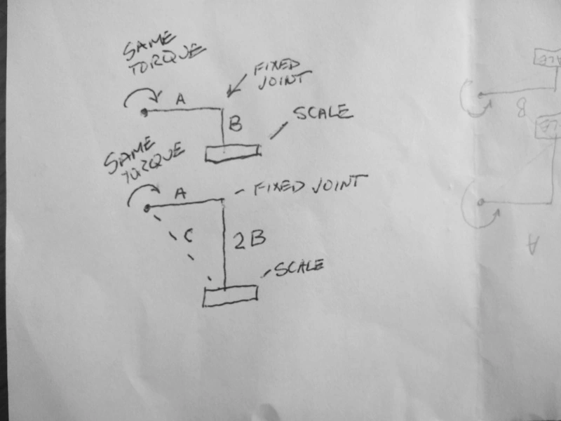

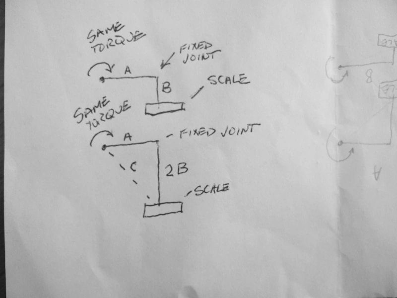

I have a question that I've gone back and forth on several times, trying to visualize it's driving me nutz! It relates to a Prony brake I've built for a model hot air engine, but I'm going to generalize it here as best I can as just a mechanics problem. See attached sketch.
My question is, with a given stable torque, and a horizontal arm of length (A), and another vertical arm (B) normal to the first which is on a scale (top drawing):
Does the scale read differently if you increase the length of the vertical arm? Like say increasing to 2B? (bottom drawing)
In other words, is the effective arm in both cases, the diagonal (C) the distance between the center of pivot and the contact point on the scale. Or is it simply A?
Thanks for any clarification! It really is bugging me.

Maybe if I imagine a circle around the pivot with radius A. Then the vertical arm B is tangent to it. No matter how long it is, it's still on the tangent.
So any force on B is in line with it. So the scale should read the same no matter how long it is. It's just straight compression.....?
If the scale surface is friction-less, so it only transmits vertical forces, then the lever arm is simply A, so it will read the same in both cases.
Otherwise it is a statically indeterminate problem, because you can have many different force vectors from the scale to balance that torque.

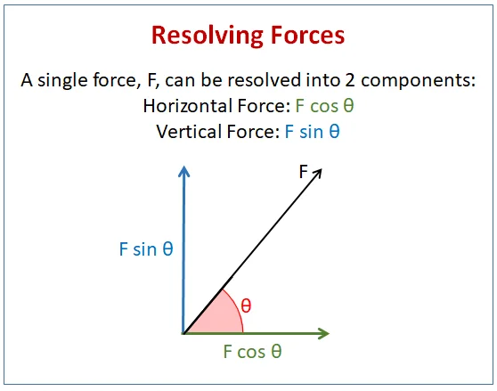

Are you familiar with basic vector math? That's the easiest way to visualize what is going on, IMO. Also, are you familiar with Free Body Diagrams (FBDs) already?

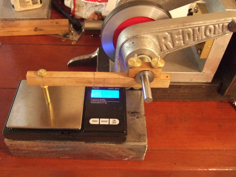

Here's a pic of the first setup, until I started to doubt the wisdom of the brass stylus. Then went back and forth on it, and finally arrived here...

That should work OK, so long as the arm remains parallel to the scale surface, and you press the tare button to cancel the unbalanced weight of the brass bolt and torque arm.

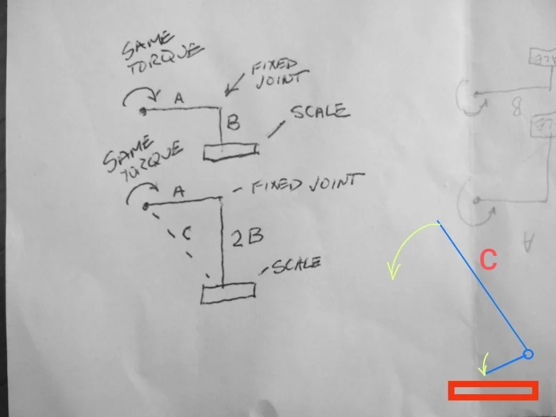

Which changes your length C and some angles. Can you draw the FBDs with angles shown and do the torque equation calculations?
Thanks @Baluncore, I agree.

@berkeman thanks. I believe (now) that distance C (an imaginary diagonal) is irrelevant. I can't do the math you are asking for, but I do feel I have an adequate mental picture now, once I considered that B is a tangent to a circle with radius A around the pivot point.
The force transferred in a tangential direction is always perpendicular to the radius at that point. No matter how long the tangent line is, the momentary force is along that tangent line. That is the vector direction, if you will.
Since the scale is perpendicular to that tangent (and force) it will always read the same, whether the tangent is short or long.

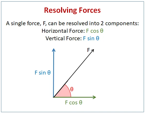

In your setup, it is relevant. The force ##F## at the tip of the bolt on the scale is with respect to the length ##C## (##F=TC##), and that force is perpendicular to the arm ##C##.
Your scale can only read the vertical component of the force ##F##. Technically, you should do some math to find the true value of ##F##:
So the relationship between the torque ##T## and the vertical force ##F_v## would be:
$$T = FC = \frac{F_v}{\sin \theta}C$$
With your setup, the difference might be negligible, but it is the correct way to look at it.
To eliminate that problem, you need to change the way you fix your vertical link. It should be fixed with respect to the scale, and arm ##A## should only rest on top of the vertical link ##B##. That way, the torque ##T## is ##FA## where ##F## is truly perpendicular to the scale, thus no correction needed on the reading. You are basically extending the scale surface instead of extending the arm.

Brass on steel can have a static friction coefficient of up to u = 0.51 (dry) or u = 0.19 (lubricated):
https://www.schneider-company.com/coefficient-of-friction-reference-chart/
Your max. relative error for the torque will be roughly u * B / A.
To minimize the error you can:
- lubricate the scale surface
- attach a bearing / roller to the stylus tip
- make B as small as possible compared to A (lift the scale instead of extending the stylus)
- make sure A is parallel to the scale surface

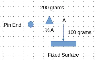

Yes, and I believe in this case theta = 90 degrees. I may be wrong, but this is exactly the crux of why I've gone back and forth on this. And looking at the posts above by others, why they don't all seem to agree.

I believe I am not applying torque to the scale surface, assuming everything is square, flat, and level, and the scale uses a solid pressure transducer, not a spring action. I doubt whether greasing the top of the scale or adding a strip of Teflon, would make a measurable difference. But I certainly could do that and check the difference. But that is a practical matter anyway, and I really, trying to clarify the theoretical situation -- the ideal case.
As I see it now, this situation can be mimicked by a weight on a pin ended beam in statics. No matter what length support is put under the end to the fixed surface, it still sees the same vertical force (100grams). As long as everything is, again, square, straight, level, and unmoving. Here's a pic of how I'm imagining this as a static situation:
And in that situation there is no horizontal component, so no friction. Again this is the ideal case I'm trying to picture.

'No friction' is an assumption or specification you have to make, in order to conclude, that the vertical force on the fixed surface is 100g * g.
It doesn't follow from the whole thing being static alone, because it is staticaly indeterminate, if friction is not assumed to be zero.

@vtsteam
Is this the friction part of the Prony break?
If so, it seems to have contacts at the left and right, rather than just top and bottom.
That can skew your lever arm length A.

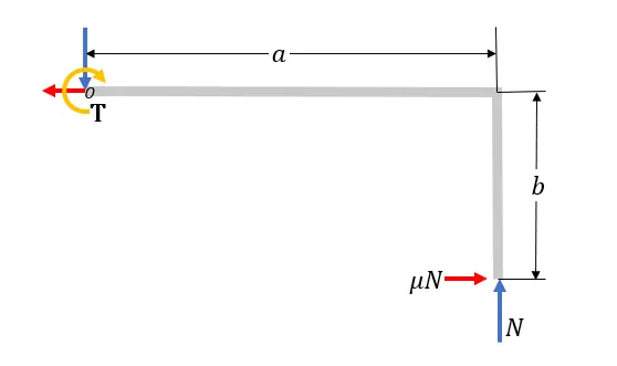

Sum torques about ##O##:
$$ T -\mu N b - aN = 0 $$
$$ \implies N = \frac{T}{\mu b + a } $$
I imagine if you take proper care to set it up, and that deflections are not large it should be in the ballpark.
At any rate, even if a small bit of friction is present at the tip, how sensitive is the scale to lateral loads?

Thanks @256 bits, you're seeing the nuts loose and the block raised a lot before tightening to get a reading. Also there is a metal flange on the drum in front of a relieved area on the face of the wood block. The real contact area is inside this. The blocks were bored on a lathe to a .001" interference fit, and that area is out of sight. In use, the contact pattern on the actual wear area shows it is even on the top of the block.
The photo shows the thumbscrews not tightened, and no springs under them, because it is an early demo running pic with no pressure, and nothing permanent. All components are now bolted down on a permanent base, etc.

Hi @erobz, just saw your post after I wrote mine. Thanks for the great diagram and formulas! The scale uses a pressure cell rather than a spring and has a kilogram range, while my actual measurements are in the sub 20 gram range, so deflection is nil. I would say that the only horizontal forces would be the result of vibration from the engine. It is a small Stirling engine, and everything is solidly bolted down to a single base plate now. I mean, I think the setup is reasonably good for output measurements for a hobbyist experimenting with mechanical engine changes. I just wanted to make sure I wasn't making a serious blunder by thinking the moment arm was length A (in my original post) instead of length C.

You are mixing up torque (then bigger C produces more torque) with pressure (compression).
See sketch.
You need the following (or SIMILAR) if you want to apply more VERTICAL pressure on the SCALE. Then the more length you give to C the more pressure you apply. Note the blue dot must be fixed and rotating.
