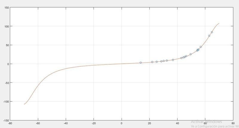

As the magnetic force increases as the magnets are close between them, i did an force vs displacement static test, this is the result:
Plot of a smooth curve of force in newtons against displacement in millimetres, rising steeply at both ends, with blue circle markers clustered near the centre and at the upper right.
(result of horizontal test, load(N) vs relative displacement(mm))
dots means this is one direction test u+, as magnets are placed symmetrically u- is supossed to be equally.

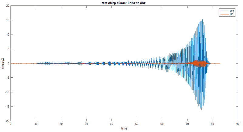

I will share with you this test: table shakes with amplitude=10mm, frequency is increasing exponentially from 0.1hz to 5 hz.
Time-history plot titled 'test chirp 10mm: 0.1hz to 5hz' showing acceleration in m/seg2 against time from 0 to 90, with two traces: U''g (blue) growing to about plus or minus 15 near t=75 and U'' (orange) much smaller.

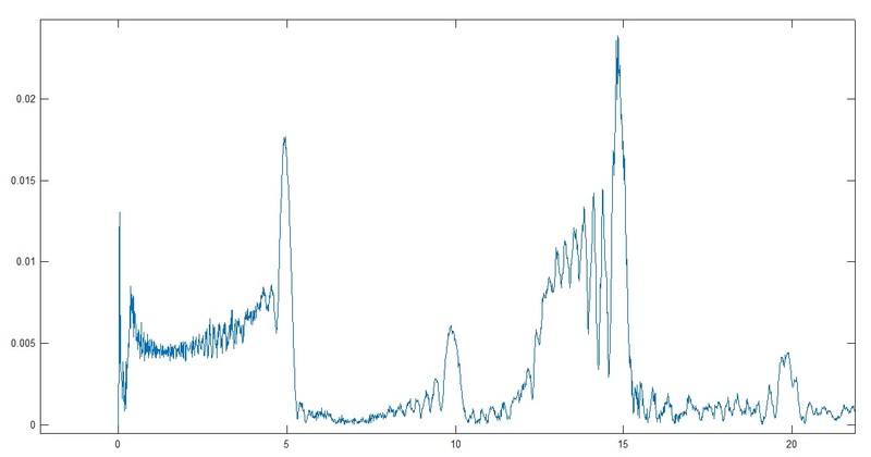

the image shows what accelerometers captured, before seg70 the system doesn't shake almost a thing. but, it starts shaking in (relatively) high frequencies with ~4.5hz. confused, i send that response to frequency domain and found:
Line graph of a power spectrum with frequency on the horizontal axis from 0 to about 22 and amplitude on the vertical axis from 0 to about 0.024, showing a sharp peak near 5, a peak near 10, a dense cluster of peaks between 12 and 15 reaching the highest value near 15, and a smaller peak near 20.
frequencies over the frequencies at which the table was shaking!

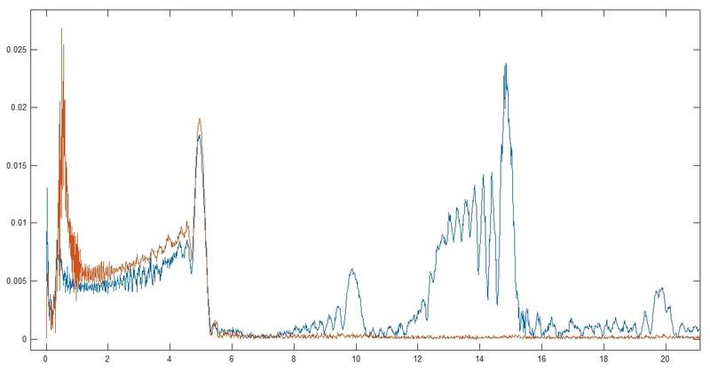

My attempts for solutions are made using matlab'simulink solving motion equation and optimizing damping 'c' value, got this:
Line graph of a signal amplitude against frequency from 0 to about 21, with two overlaid traces: an orange trace with a large peak near 0.5 and a blue trace with peaks near 5, 10, 13 to 14.5 and 20.

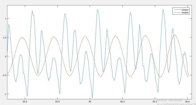

(My model is orange one) My model doesn't simulates frequencies over the ones at which the seismic table is shaking. this, in the time domain looks like this:
Line plot of two time-history signals, blue labeled ensayo and orange labeled modelo, with amplitude from -1.5 to 1.5 against time from 0 to 90; both stay near zero, grow strongly around 70 to 80, then decay.
and if i make zoom at it:
Line graph of two oscillating curves over time from about 55.5 to 56.6: a blue curve labelled ensayo with larger, irregular swings between about -1 and 1.2, and an orange smooth sinusoid labelled modelo between about -0.6 and 0.6.
(don't get confuse by time axis, it's the same graphic, i move the time but the idea is the same)
summarizing, i made the tests, i have to make the matlab's model, i can't figure out where those out of test frequencies are coming.

I don't have any idea where the extra frequencies are coming from.
Is your model ringing somehow? could it be an echo? or operating at a higher frequency than you expect?
Some internal motion would be my first guess as well. Where is the accelerometer and how is it attached? How well are the magnets fixed?
Could there be some slip between wheels and test object?
I'm surprised that your measurement has larger peaks at higher frequencies, but I'm not surprised that the exist in general - nonlinearity of anything can induce them.

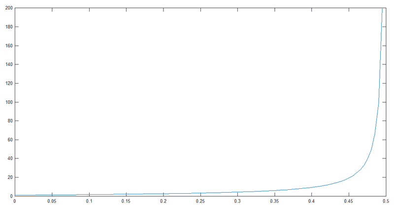

hi, in these days i have been testing an new approach of the damping force (eddy currents) as i found it is linear in almost static cases which is not my case.
my old approach was:
$$ F_d=c \cdot U' $$
my new approach is:
$$ \frac {0.5} {0.5 - \sqrt { U'}} \cdot c $$
mulltiply by the sign of U' as square root is only usable in positive numbers
this force is show like this:
Line graph of a rising curve that stays near zero up to about 0.4 on the horizontal axis, then climbs steeply toward 200 on the vertical axis near 0.5.
$$F_d \left[ N \right] vs U' \left[ \frac m {seg} \right] $$

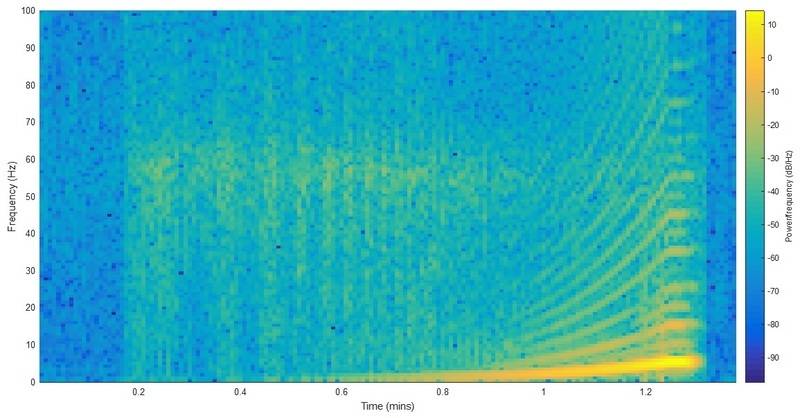

as you can see now i get the 15 Hz ghost freq, but the frequency of the test (from 0.01 Hz to 5 Hz) goes over the skies! so i thought in looking relationship between velocities in time and spectrogram:
Simulation plot of relative velocity against time: a yellow oscillating signal stays near zero, then its amplitude grows sharply after about 50 seconds, peaking near 0.25 before decaying to zero around 80 seconds.
m/seg vs time (seg)
Spectrogram of frequency (Hz, 0 to 100) against time (mins, 0.2 to 1.2) with power in dB/Hz colour scale; a bright band sits near 5 Hz rising at the end, with curved harmonic-like traces rising to about 60 Hz near 1.25 min.

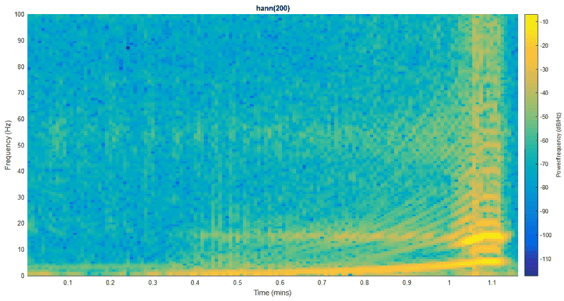

spectrogram of my acceleration simulation signal which is actually getting close to the 'real live' testing in lab spectrogram:
Spectrogram titled hann(200) of frequency in Hz (0 to 100) against time in minutes (0.1 to 1.1), with power in dB/Hz shown by colour; a strong band near 0 to 5 Hz rises with time and a brighter band near 15 Hz appears after about 0.8 minutes.
so, the good news are i am getting the '15 hz' frequencies, but the bad news are the amplitudes of my 0 to 5 hz frequencies

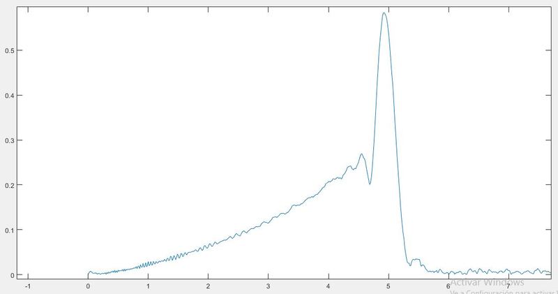

jedishrfu: i don't understand what is ringing :v ; i don't think this is echo because the sensors were quality tested ; no, the test were from 0.01 Hz to 5 Hz. this is frequencies domain of ground accelerometer:

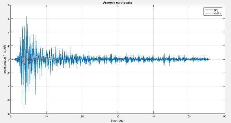

sorry, can't make more lab test as they tell me that the ones i have already should be in off to make the model, nevertheless i made an extra test for an specific earthquake:
Line graph titled Armenia earthquake plotting acceleration (m/sec^2) against time (seg) from 0 to 60 s, showing a large oscillating U*g trace peaking near ±6 to 7 between about 3 and 7 s, with a smaller device trace in orange, and both decaying to near zero after about 20 s.
