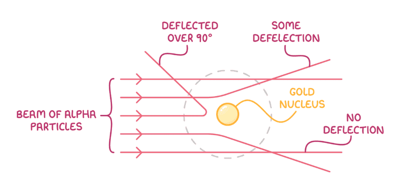

From that picture, I thought it was clear from "some deflection" that the nucleus is positively charged since the deflection is always going away, never going towards
So maybe it is enough to conclude the force is repulsive and since alpha is positively charged then there should be another positive charge repelling alpha?
Thanks

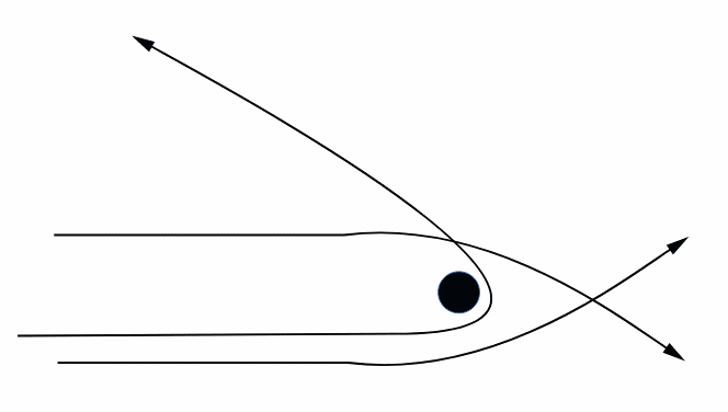

The ##\alpha## particles could be attracted to - and therefore deflected when passing close to -fixed negative charges. Like this:
(No accurately drawn.)
Without some additional information, you can't tell solely from the experimental results (angular distribution of scattered ##\alpha## particles) whether the deflections are caused by positive or negative charges.
But, with the premise that an atom consists of negative electrons and positive charge, it is reasonable to propose that the fixed charges are in fact positive.
