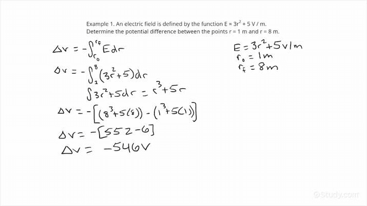

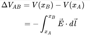

If the voltage between two points is the negative integral from A to B of Edl, then in a given problem where it asks me to find the voltage between two points, how do I know which is A and which is B? Will both a negative and positive answer be accepted since its relative, like for example point A is +2V compared to B but B might be -2V compared to A?

"between" is symmetric. It does not imply a direction, so the answer would be a magnitude. But is that the word used in the question?
My usage of the word voltage, with which some PF users disagree, is to denote the absolute value of the potential difference between two points. If I want to refer to a quantity that could be positive or negative, i use "the electrostatic potential difference between from A to B".
When one writes ##Q=CV## for a capacitor, ##V## is called the voltage across the capacitor and is assumed to be always positive.

No, I am just asking generally, it hasn't come up in a question. It just confused me tho. Does magnitude mean it's always positive?

Idk, I saw a question online that was like find the potential difference between A and B so I got confused.
:ok:That makes sense. Thanks.
