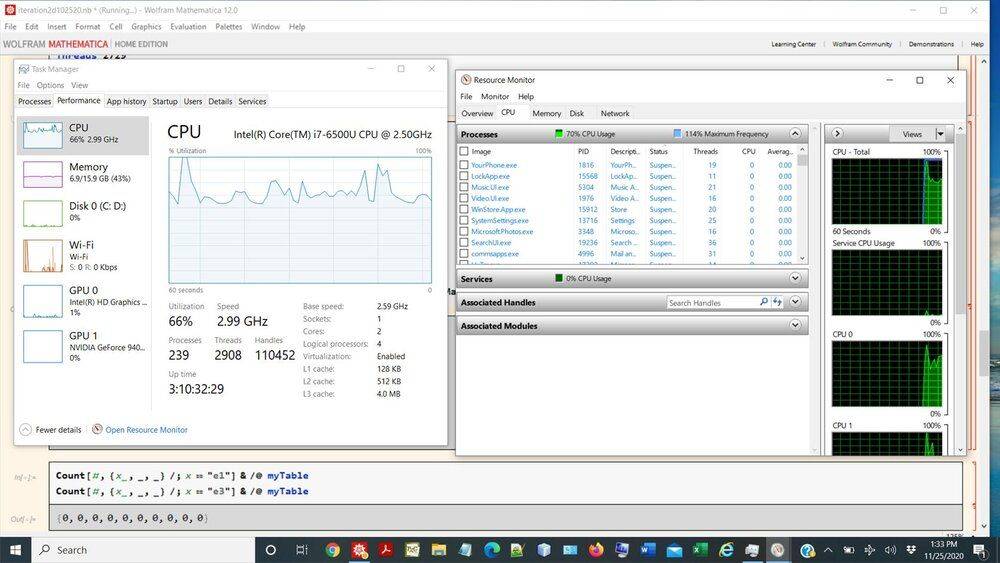

This is an example of my machine:
Processor Intel(R) Core(TM) i7-6500U CPU @ 2.50GHz, 2592 Mhz, 2 Core(s), 4 Logical Processor(s)
running ParallelTable in Mathematica using 2 cores. Note the base speed is 2.5 GHz but my CPU is showing 2.99 GHz which is the 114% frequency shown on the screen on the right.
Does this mean each core is running at 2.99GHz or the total number of cycles that both cores execute in one second is 2.99 billion?

I'm sorry but I thought I answered this. I'll repeat it, but that usually doesn't help. Each core runs at 2.99 GHz.

I see you mean mean light load across cores. What do you mean that turbo boost is unlikely if all cores are running full out though? When I run all cores full out it's still 1ghz above base clock.
What's shown in #3 is a CPU at 66% load running a hair under 20% faster than base. That's a pretty good boost, but the processor is still only doing 79% of what it would do running 4 cores at the base rate.
TurboBoost is intended to speed up single-threaded workloads on multicore processors. Since speed is limited by heat, one can run one core faster if the others are idle. If all cores are running full out, the chip is likely near the base frequency. Because that's what the base frequency means.
