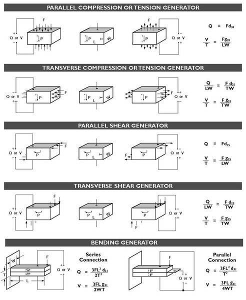

Here's some equations to play with from http://www.piezo.com/tech2intropiezotrans.html

Never mind what I said about transformers and charge pumps. These things actually develop much higher voltages than you need. They don't work like batteries, with specific output voltages. You can think of them as capacitors which develop a charge between the plates when flexed. The voltage is a consequence of charge (coulombs) and capacitance (farads). Hooking it to a battery through a full wave rectifier allows current to leave the device as soon a the voltage is high enough to overcome the batteries opposition. This prevents it from getting much higher than the battery voltage.
