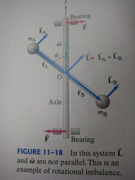

Suppose in the given figure that mB=0; that is, only one mass, mA, is actually present. If the bearings are each a distance d from O, determine the forces FA and FB at the upper and lower bearings respectively.
(This is from Physics for Scientists and Engineers, by Giancoli)
Equations for angular momentum and torque? τ=dL/dt
I'm having trouble understanding the example where both masses are present. If L does not always equal Iω, then when exactly is this true?
I think I should understand the example where both masses are present first. If I want to find both forces in the figure, what equation should I start with?
  • Diagram of a rotating axle along the z axis with two masses, mA upper left and mB lower right, on arms rA and rB from point O, showing angular momentum vectors LA and LB, their sum L, angular velocity omega, and bearing forces F at each end.

The angular momentum vector of a rigid body is only aligned with the axis of rotation if that axis is a principal axis of the body.
You're probably thinking that LA on its own obviously is vertical (and so is LB), so why isn't the total L also vertical?
The diagram is misleading … it suggests that each mass has an "intrinsic" L.
L depends on the point about which you measure it …
looking only at mass A, and measuring the moment of inertia about a point P a distance r from mA, there's an extra mAr2 term only in directions perpendicular to PA, so only those directions (and the single direction PA itself) are principal directions …
so if P is the point PA, on the axis at the same height as A, then the angular velocity is perpendicular to PAA, and so is along a principal axis, and therefore so is the angular momentum, LA …
but if P is the point O (or PB), then the angular velocity is not along a principal axis, so LA is at a slight angle to the vertical.

Thanks for replying. I'm still a little confused, but I'm not sure what to ask right now.
tiny-tim said:
Looking only at mass A, and measuring the moment of inertia about a point P a distance r from mA, there's an extra mAr2 term only in directions perpendicular to PA, so only those directions (and the single direction PA itself) are principal directions …
How would you measure moment of inertia with respect to a point? Isn't it done with respect to an axis? What extra mAr2 term are you referring to?
Okay... so L and ω are go in the same direction if and only if ω lies on a principle axis? And when this is true, we must have L = Iω?

Hi azure kitsune! :smile:
ah, I started saying "a point" when I was talking about the angular momentum, L …
and then I decided to carry on the theme :rolleyes:
yes, strictly speaking I should have said "measuring the moment of inertia about an axis through a point P a distance r from mA, there's an extra mAr2 term only in directions perpendicular to PA" :smile:
It's in the parallel axis theorem … see http://en.wikipedia.org/wiki/Parallel_axis_theorem …
IP = Ic.o.m. + mAr2
meaning that the moment of inertia about an axis through P equals the moment of inertia about the parallel axis through the centre of mass, A, plus mass times the square of the perpendicular distance, r, from A to the original axis.
(so for the axis parallel to PA, r = 0, and so IP = Ic.o.m. as expected, but for the perpendicular axes, r = |PA|)
Thanks for clearing that part up. It makes more sense now. So because angular velocity and angular momentum are measured with respect to different things, they don't always point in the same direction.
I'm still wondering something though. When you were talking about the mass A and the point P, you talked about a lot of different axes of rotation. Isn't there only one axis of rotation for the object though? So are these other axes ever important?
And another question: If L and ω do not point in the same direction, is there still a relation between them?
Thanks for your help tiny-tim! :)
No, angular momentum is measured about a point, while angular velocity is not measured about any point or axis, it just "is".
To put it another way:
Angular velocity is different for different inertial frames (frame means the velocity of the observer), but in each frame it is independent of position (go further away, and the angular velocity stays the same).
Angular momentum is also different for different inertial frames, and in each frame it is also different for different reference positions (go further away, and the angular momentum gets bigger).
And moment of inertia is measured about an axis (go further away from the parallel axis through the centre of mass, and the moment of inertia gets bigger).
Moment of inertia is measured about an axis. Those are the only axes I was talking about.
(And yes, there is only one axis of rotation.)
Yes, L = Iω, where I is the moment of inertia tensor.
