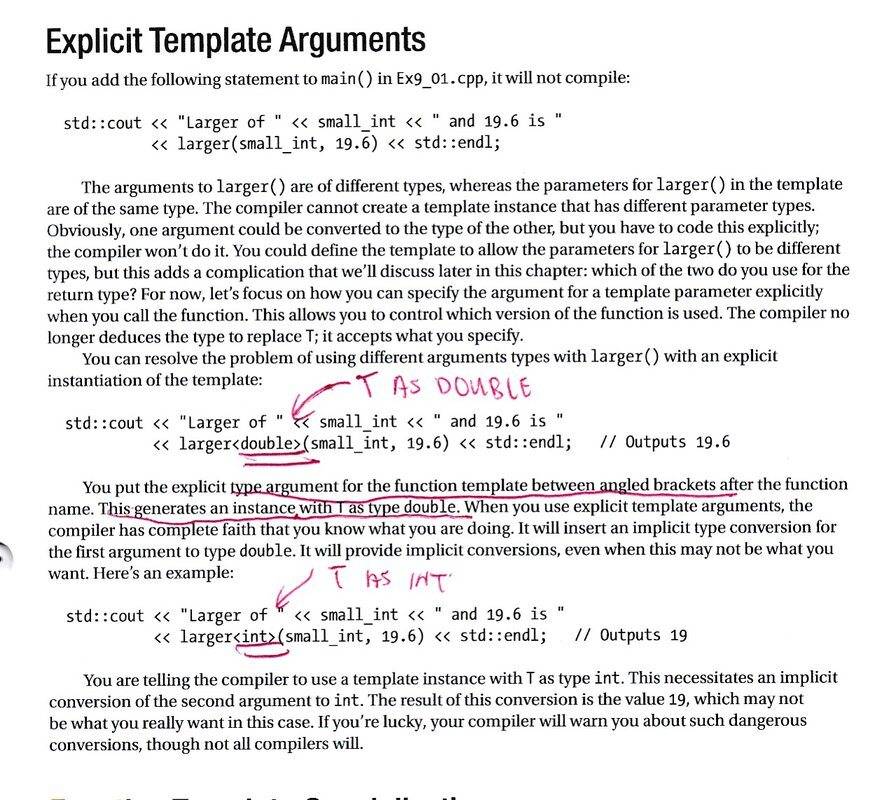

Thanks all, this explicit template arguments is from Ivor book, I just thought if I can do it without much fuzz, then maybe it's useful. I am not going to pursue this anymore.
Hi Mark, I don't remember I saw your example, I have to look into your example.
Thanks

Hi Mark
I did not see this, I just starting to learn templates. Looks like you are keeping things simple, not trying are the twist and turn. That's what I learned in the Gaddis book.
Since I have the Ivor and Lippman book, I read more on function. Ivor has a lot more twist and turns. This is one example in the book.
Maybe I should not study too much pass what you show in your example.
Thanks

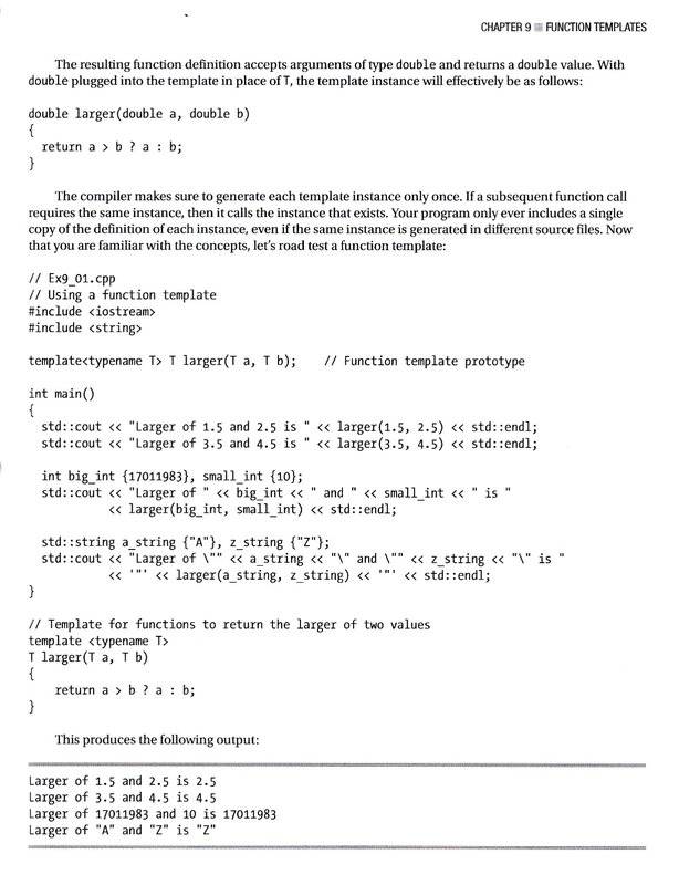

Without seeing how the larger() template function is defined, I can't comment on the text from Ivor or your notes.
It looks like larger() is defined something like this:
C++:
template <class T>
T larger(int smInt, T val)
In the above, only the second parameter is templatized, but again I haven't seen the code, and I don't know how the body of the template function is implemented.
Some examples of how this template function might be instantiated:
C++:
int smInt = 5;
int iResult = larger<int>(smInt, 14);         // Should return 5
double dResult = larger<double>(smInt, 3.0)  // Should return 3.0

Yes, I should have attached the original program. Here it is:
It works if I use function with return as it won't go out of scope until it return to the main program. It just won't work if you have multiple values to get back to main().
This program works if I only need to return one value:
C++:
#include<iostream>
#include<string>
#include<cstring>
using namespace std;
template<class T>  T larger(T a, T b)
{if (a > b) return a;else if (b > a)return b; return a;}
//{    return a > b ? a : b;}
int main()
{    double x=2.5, y=4.5; count<<" larger of x and y is: "<<larger(x, y)<<endl;
    int big=4,small=1;count<<" larger of big and small is: "<<larger(big, small)<<endl;
    string a="Alan",b="Alan";count<<" larger of string a and b is: "<<larger(a, b)<<endl;
    count<<" larger of big and y is: "<<larger<double>(big, y) << endl;// This one works using return from larger.
    return 0;
Thanks

Snipped from your example in post #10:
C++:
I haven't attempted to compile your code, but you are not calling the template function larger() correctly in these three lines.
The first line should have this call: larger<double>(x, y)
The second should be like this: larger<int>(big, small)
The third should be like this: larger<string>(a, b)
Your fourth line, not shown above, is written correctly, but I don't understand what your comment is trying to convey: "This one works using return from larger."

Hi guys
There is a lot of confusion in this thread. I want to sum it up, please bear with me. My original question is on EXPLICIT argument that I can use only one template to work on two different types of variables. I want to gather everything into this thread, it's going to be long. It all started out with Ivor book program 9.1. Then it introduce the explict argument in the second page of the book shown below:
Here is book introducing explicit argument using program 9.1 above:
You can see by using <double> or <int>, it can force the program to work with two different types of variables with a single template declaration.
But I found the application is very limited. For function that return the variable, it will work as shown in the following program:

yungman said:
Now, this is really my question from the very first post. Is there any easy way to make it work to return back two variables like it the Swap program.
Yes.
C++:
#include <iostream>
template <class T>
void swapVars(T &var1, T &var2)
    T temp = var1;
    var1 = var2;
    var2 = temp;
int main()
    double x = 1.0, y = 2.5;
    swapVars<double>(x, y);
    std::count << x << ", " << y << std::endl;
The code for swapVars() is almost identical to yours. The main difference is in main(), in how swapVars() is called (and instantiated).
