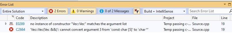

Apparently I still running into issue of passing c-string as parameter. Here is the very short program and you can see one way works and the other doesn't:
C++:
#include <iostream>
#include <cstring>
using std::ostream;
using std::count; using std::endl;
const int size = 25;
class Vec
{private:
    int x, y;
    char name[size];
public:
    Vec(int x0, int y0, char *desc)
        { x = x0, y = y0;
          strncpy_s(name, size, desc, size);
int main()
{    char vecA[size] = "vecA";
    Vec a(1, 2, vecA);//This works
    Vec b(2, 4, "vecB");//This doesn't work.

Line 20 just won't work. Why?
Thanks
Already answered. See post #67. Again, please read what others and I write. It's disrespectful to us and wasteful of our time when we answer a question that you've asked, and you don't read the responses, and ask the same question again.

Mark44 said:
See post #67.
To elaborate a bit on the statement in post #67:
A literal string such as "vecB" doesn't have type char *. It implicitly has type const char *, because it makes no sense to change the value of a literal string.
You can't pass a const char * to a function that declares a parameter to be char *. When you declare a parameter without specifying const, it signals to the compiler that the function might change the value of the parameter.
Therefore, if you want to be able to pass a literal string to a function, you must declare the parameter as const char *.
(On the other hand, you can pass a char * (e.g. a char array that isn't declared as const) to a function that declares a parameter as const char *.)
[oops, yungman quoted this while I was editing it for clarity.]
A literal string such as "vecB" doesn't have type char *. It has type const char *.
You can't pass a const char * to a function that declares a parameter to be char *. When you declare a parameter without specifying const, it signals to the compiler that the function might change the value of the parameter. However, it makes no sense to change the value of a literal string, so those are always implicitly const char *.
THANK YOU
This is what I need. I have not seen any explanation on this before. That's why I make mistake and don't even know why. Whole day today has been tripped by the c-string copying and passing parameter. this definitely will be in my notes.
that's why when I read Marks reply again, I still didn't understand until your post just pop up! Just like in your thread, everyone replied sounded like they think everyone knew all that, that was NEW to me, that was an eye opener! That's why I spent over a week now on your post and I refuse to move on until I get everything to learn out of it.
Actually I am in the process of writing out the program without looking at any of the stuff, line by line reasoning out, step by step doing it again.
Thanks
You might want to check the revised version of my post. I was in the middle of editing it when you quoted it. I didn't change the main point, just tried to make it clearer (hopefully).
