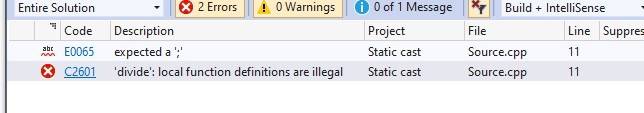

I have to complete the program as shown below but compiler doesn't like it.
C++:
#include <iostream>
#include <functional>
using namespace std;
int main()
    int numerator, denominator;
    double result;
    count << " Enter numerator = "; cin >> numerator;
    count << " Enter denominator = "; cin >> denominator;
    double divide(int numerator, int denominator)
        if (denominator == 0)
            count << " Error, cannot divide by zero.\n\n";
            return 0;
        else { return static_cast<double>(numerator) / denominator; }
    count << " Result of divide = " << divide << "\n\n";
    return 0;
I looked online on divide(), apparently it is a bigger function and I don't quite understand how to set up the parameter. I read this link:
https://en.cppreference.com/w/cpp/utility/functional/divides
Looks to be the first parameter is the numerator and second is denominator. But obviously it doesn't work.
When I ran the program, this is the error message:
I don't know how to fix it, please show me how to fix it.
Thanks

I was looking at it, is divide() just any function like Func() and do it like this:
C++:
#include <iostream>
double result;
double divide(int, int);//Just a function called divide
int main()
    divide(numerator, denominator);//Call function divide
    count << " Result of divide = " << result << "\n\n";
    return 0;
double divide(int numerator, int denominator)//function to divide
        return 0;
    else
        result = ( static_cast<double>(numerator) / denominator) ;
        return result;
This is the output:
Enter numerator = 2
Enter denominator = 3
Result of divide = 0.66667
Everything is correct. I got fooled by the partial code in the book!
The book didn't fool you -- you forgot something that I'm sure the book said many chapters back, namely that you can't insert the body of a function inside another function. You can't do that in C, C++, Java, Fortran, and many other languages.

Still not correct. If you attempt division by zero the function leaves 'result' uninitialized. It could return anything. If you are going to use the global, the function should be declared to return void. The return is being ignored by the only caller anyway.
Instead of returning zero, the error path should do something like:
result = std::numeric_limits<double>::quiet_NaN();

Certainly you shouldn't make result global and modify it within divide. A better implementation would be:
C++:
#include <iostream>
int main()
    double result = divide(numerator, denominator);
    return 0;
        return 0;
    else
