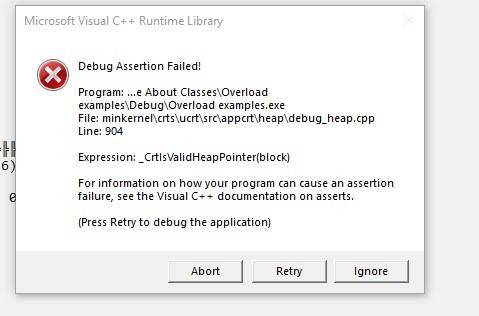

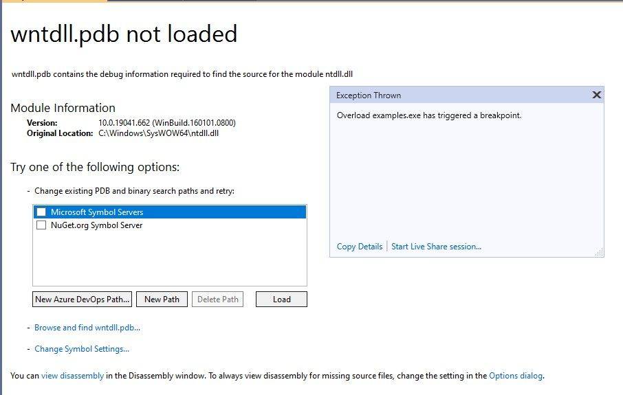

I am trying to wrap up this program, I notice I forgot to delete the dynamic allocated memory in the Destructor as I added the name = new char[size] everywhere. So I added the line delete name[]. The debugger gave me this:
What is this?
Edit:
I stepped through, it was going into Destructor of Temp object when things went wrong. it gave me this page:
thanks

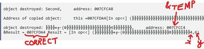

Guys
I am not sure I can agree reading rhs.name gives me garbage is about not a deep copy. The reason is we all know:
1) in operator+(), temporary object sum is created to store Left + Right.
2) Then sum is copied into object Temp that is another temporary object.
3) Sum is destroyed.
4) Temp is copied into Result by operator=() where parameter &rhs is reference to Temp.
I know that because in operator=(), x = rhs.x, y = rhs.y. This copy the value into Result to display in line 15 of main(see post 1).
BUT remember, the values of x and y were copied over to Result by operator=() in line 39 of header file. Then using operator <<() to display. It will display Result.name = "Result".BUT if you look at both operator=() and operator<<(). ONLY x and y is being copied over and nobody touch the name in Result. That's the reason when display Result.name, you get "Result".
So I did an experiment. I modify the operator=() and operator<<() by adding name=rhs.name and output v.name resp. You can see the printout that when I display Result, I got garbage.
C++:
     Vec& operator= (const Vec& rhs)//count << rhs.name don't work, but &rhs works why?
        { //count << "\n [in op=] rhs.name:" << rhs.name << ",  address: " << &rhs;
          x = rhs.x;   y = rhs.y;
          name = rhs.name;//adding this line
          count << "\n Address of copied object:     this =" << this << *this << endl;
          return *this;
     friend ostream& operator<< (ostream& out, const Vec& v)
        { out << "[In op<<] " << "(" << v.name << v.x << "," << v.y << ")";//adding v.name.
          return out; }
ONLY one way can be right. I showed x and y are copied over from Temp to Result. BUT in the same function after I added the name, the garbage is copied over. I don't think this is about deep copy. The information in name is lost.
This is the copy of the printout of the few lines executed:
You can see Temp is destroyed in the second to the bottom line with the correct address. Last line is from line 15 of main verified with correct address. you can see the garbage, BUT you can see correct value of x and y as show. How do you explain by deep copy?
Something is really wrong here. Program is NOT working. If you have a c-string that you need to pass on, it will give you garbage. It just happened the two number got passed correctly.

Jarvis323 said:
Say you have a house, and it has an address. You can give someone a copy of your address (shallow copy), or you can make then an actually copy of your house (deep copy).
If you have your house demolished, the address you gave will be an address to a demolished house.
In other words, shallow copy is like "Mi casa es tu casa". Deep copy is like, I built you a house that's just like mine.
Now vec::name is a memory address. You set name=temp.name (shallow copy). When temp is destroyed, the memory it held is now garbage. So name, is now a memory address to garbage.
Thanks for the reply.
But I already show Temp was destroy after I got the garbage. You can see clearly in post 17, Temp is destroyed in the second to the last line, I got garbage the line before that. Temp was not destroy at the time. Can you explain that with shallow copy?
I am looking into what I did wrong with copying c-string. I was wrong on name = rhs.name. to copy c-string. It has to be strncpy_s(name, size, rhs.name, size). But there is a problem with c-string inside class definition I still don't understand. I am also looking at using std::string.

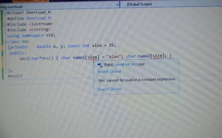

{private:   double x, y; const int size = 25;
public:
     Vec(char*desc) { char name1[size] = "Alan"; char name2[size]; }
#endif

yungman said:
I can see red wiggle line under "size",
Which one? If I add a member named size to the class that jtbell wrote, the program compiles and runs with no problems.
C++:
class ThreeVector
private:
    double x, y, z;
    int serialNum;          // unique for each ThreeVector instance
    static int numVectors;  // counts the number of ThreeVectors constructed
Is the red squiggly line in your constructor that takes a string argument? If so, hover over the squiggly part and VS will give you a clue as to what's wrong.

This is the picture, I have to take a picture with camera to show what the message said having the arrow on the red wiggle.
I so wish I can get pass this and at least do my best to learn about c-string passing into the class object. There should be no reason to use name = new char[] every time that I have to delete name[].
