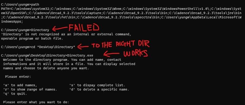

Hi
I am learning Command Line CMD. I cannot do what this video do in searching and running an executable file(.exe). This is the video:
If you start watching at about 2:30. It talked about how to make the CMD to run the .exe file not in the current directory by first run "PATH". My problem is my executable file Directory.exe is in a folder called Directory on Desktop. When I type path, there is no path to Desktop and I cannot run the Directory.exe. It will not find it. BUT if I actually go to the Directory, it will run as show in the screen shot below.
As you can see I followed the instruction in the video and it doesn't work. But if I change directory to the right place, I ran the program.
Please tell me what I did wrong.

Path just lists the value of the environment variable path. You didn’t change anything.

When you type path it gives you the current value of the environment variable path. This is the first command you ran in your example.
The environment variable path is a list of directories to search in for an executable.
The video you posted shows how to add directories to your path (modify the environment variable path) through the gui (not cmd) at ~5:50.

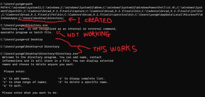

Hi, I follow the instruction of 5:50 and created the new path to Directory folder where the Directory.exe in. You can see in the CMD that I have the path this time. BUT it still didn't work as shown.
I verify and manually type cd Desktop, then cd Directory. Then I type in Directory.exe. It works as shown.
I don't know what I did wrong. I follow all the steps to add the path. You can see it shows at the last line when I type "path" above.
What else goes wrong this time?
Thanks

In your screen shot, the current directory is apparently C:\Users\yungm and the prompt is C:\Users\yungm> When you added Directory to the command window prompt, it didn't recognize this command. The reason is that there is no such command. There is one called dir, which is short for directory.

You didn't add the correct thing to PATH. You forgot the "yungm"
Yes, I went back and check, I forgot "yungm". It's working now.
