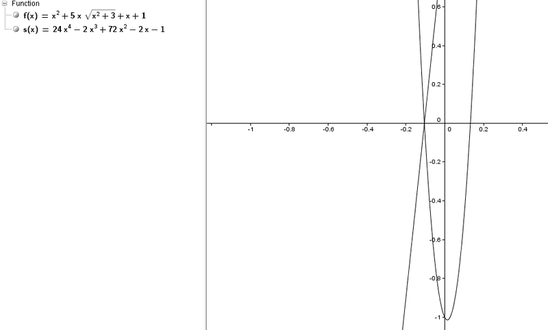

Here's a graphical representation of the two equations:
That's nice to see, a graphical representation always helps think about things. Sadly, this equation was just a thing that I pulled out of thin air as a simpler example for the true problem at hand. The "isolating the root and squaring" method should still hold in my case, though.
