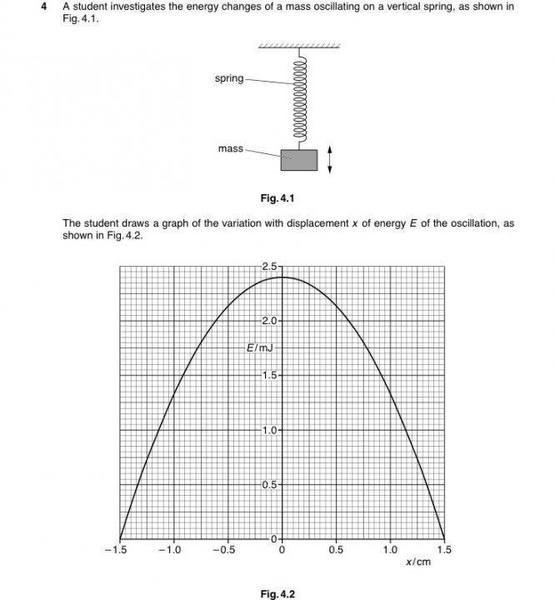

1. Homework Statement
Graph of energy E in mJ against displacement x in cm for a mass on a spring: a downward-opening parabola peaking at about 2.4 mJ at x = 0 and reaching 0 at x = ±1.5 cm, with gridlines and labelled axes from -1.5 to 1.5 cm and 0 to 2.5 mJ.
Text of part (b) of an exam question: the student repeats the investigation with a smaller amplitude, the maximum value of E is now 1.8 mJ, and Fig. 4.2 is to be used to determine the change in amplitude.
KE=½m(ωa)2
So first I did this:
2.4x10-3= ½ mω2(1.5x10-2)2
To find mω2=21.33
And substitute that into the KE eqn to find the new amplitude, which is 1.30x10-2
But I only did that because that was the only way I could think of.
My question is, why is ω constant despite changes in the max KE?

ehild said:
How does the max KE depend on ω and the amplitude?
Max KE=½m(ωa)2
Janiceleong26 said:
Max KE=½m(ωa)2
Changing KE means changing the amplitude if it is the same oscillator. You know that ω=√(k/m). If the spring is the same and the mass of the load is the same, why should the frequency change?
Physics-Tutor said:
ehild is correct:
k is the spring constant, m the mass. These two are constant, so the angular velocity is constant.
Oh, I got it. Thanks a lot !
