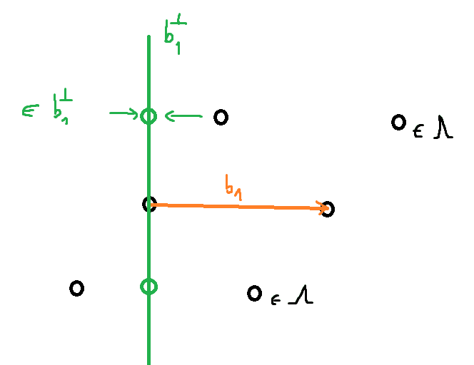

Hello,
let's say that we have a lattice ##\Lambda##. Now I take one of it's basis vectors say ##b_1## and project all the lattice points onto the line which is orthogonal to ##b_1##, this line could be calculated via Gram-Schmidt for instance. But does this then form a lattice again? It is possible to formalize this a bit more? With my definition of a lattice ##\Lambda = \{\sum \lambda_ib_i, \lambda_i \in \mathbb{Z}\}##, however, I cannot prove that this projection on the line again represents a lattice.
Some questions. Do the ##b_i## span a finite or infinite dimensional space? Are all the ##b_i## linearly independent?
Is your lattice 2 dimensional, or is there more than one choice of line to pick, or did you mean you would project onto the orthogonal hyperspace?
Thank you for your questions. So this is the question I asked myself for an ##n##-dimensional lattice. The ##b_i## are all linearly independent according to definition of an ##n##-dimensional lattice. Then I would project the ##n##-dimensional lattice ##\Lambda## onto the hyperplane orthogonal to ##b_1## (of the dimension ##n-1##), if this is thought correctly. In the ##2##-dimensional it is a line like this:
I tried to represent this graphically in 2D. The blacks are the lattice points and the greens their projection onto the plane/space/... orthogonal to ##b_1##, the point in the origin belongs to both...
In the 2d case it's not hard to see it's a lattice. Let ##c## be orthogonal to ##b_1## with unit length.
##\alpha b_1 + \beta b_2\to \beta (<b_2,c> c)## so the image is a 1 dimensional lattice generated by ##<b_2,c> c##.

For the ##n## dimensional case, you basically get the same result. Let ##P## be the projection. Obviously the projected lattice is spanned by integer combinations of ##Pb_2,...,Pb_n##. We need to prove these are linearly independent.
Suppose ##\sum_{i\geq 2} \alpha_i Pb_i=0##. Then ##\sum_{i\geq 2} \alpha_i b_i=\alpha_1 b_1## since it has to live in the kernel of ##P##
But the original basis is linearly independent, so all the coefficients must be zero.

Got it, I think those are not a basis. In general there is no reason for your projected lattice to contain an orthogonal basis.
Ok and yes I would agree with that. But I actually meant with my question rather whether ##\pi_{i}(\Lambda)## forms again a lattice.
Yes, the projection forms a lattice, and my proof gives the right basis.
##\pi_i(\Lambda)## is spanned by integer combinations of ##\pi_i(b_j)## for ##i\neq j ##. These vectors are also linearly independent - if ##\Sigma \alpha_j \pi_i(b_j)=0##, then ##\pi_i(\Sigma \alpha_j b_j)=0##. But this means ##\Sigma \alpha_j b_j## lies in the span of ##b_i##, which by linear independence of the original basis is impossible unless all the coefficients are zero. Hence they are linearly independent.
And any integer span of linearly independent vectors forms a lattice (note the integer span of linearly dependent vectors may not form a lattice, unless you happen to get lucky)
