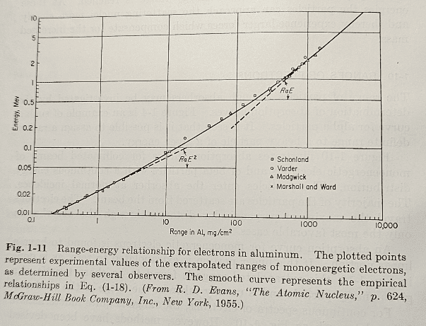

Or you can use this graph
gleem said:
Transmission = e-μd where μ =17/E1.14 with E in Mev and d in g/cm2.
Most beta emitters which one might encounter have maximum energies less than 4 Mev.
So 100 keV penetrates about 150 g/m2 and 50 keV about 50 g/m2?
Then the 80 g/m2 paper sheet stops about 70 keV?
