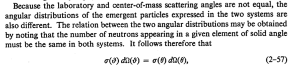

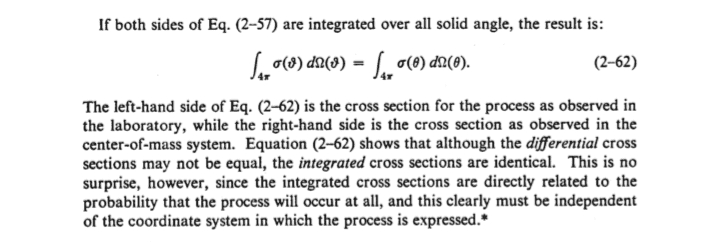

Hi, I'm reading Lamarsh's book "Introduction to nuclear reactor theory" and in chapter two there is a brief description of neutron scattering theory. I have a few questions about it.
1) In the book the author says that it is easier to analyze the interaction process in the center of mass frame, but then there is the problem to "convert" the differential cross section found in the center of mass frame to the laboratory system. In order to do so he says:
And he later continues:
This is all crystal-clear, but then he says:
Which I do not understand. (I read Section 2-8 but I didn't find anything useful...) I'd appreciate any help on this.
The math is more complicated if the target is moving.
http://farside.ph.utexas.edu/teaching/336k/Newtonhtml/node52.html
However, for a solid or liquid moderator (e.g., water), the assumption of zero velocity of the atoms, or in this case, hydrogen (protons) in the water, is reasonable, since the neutrons will have velocities orders of magnitude greater. At thermal equilibrium at room temperature, thermalized neutrons with energy ~0.0253 eV, or 2200 m/s.
One can certainly try solving the lab and CM equations with a nonzero target velocity, which is the case in a plasma, for example.

Thank you very much! I'm fairly new to nuclear engineering and I'm struggling a bit with new concepts. Your answer was very clear but I still have a question.
I read the links you posted, here I quote the first one:
http://farside.ph.utexas.edu/teaching/336k/Newtonhtml/node52.html said:
However, a cross-sectional area is not changed when we transform between different inertial frames.
This is exactly what I would expect and it is coherent with what Lamarsh says:
This assumption seems to me independent of the velocity of the nucleus so I don't understand why it should not be correct for moving nuclei (in the laboratory system)...Off Topic: Nice to meet a Satch's fan. Saw him in concert 5 years ago... Awesome :cool::cool:
It seems one is reading the old version of Lamarsh, Nuclear Reactor Theory, Addison-Wesley Publishing Co., 1965, 1972, which was the text I used for my nuclear reactor theory class in 1980-1981. Equation 2-57 is derived based on the nucleus at rest in the laboratory frame, which makes the math simpler. If the nucleus has a velocity, which is a vector, the equations become more complicated, because one must consider the momentum of the nucleus, which then affects the differential cross-section, adding an anisotropy.
However, where the target nuclei are vibrating thermally/randomly, on average, one can treat the target nucleus as having a zero velocity. The other consideration is that the normal moderator temperature in a BWR is about 272-285°C, and for high power fuel, the coolant becomes steam in the top two thirds of the fuel assembly, while in PWRs, the moderator temperature is about 290-330°C. The fuel temperature is even higher, ~370°C at the surface and ~400°C to 1400°C in the center depending on the power level. Resonance absorption by U-238 and Pu-240 becomes important, particularly during transients where the temperature in the fuel would become greater.
One could attempt the math working with a non-zero nuclear velocity. Traveling toward or away from the neutron, but then try the general case where the nucleus/atom is traveling at some angle from the direction of the neutron.
