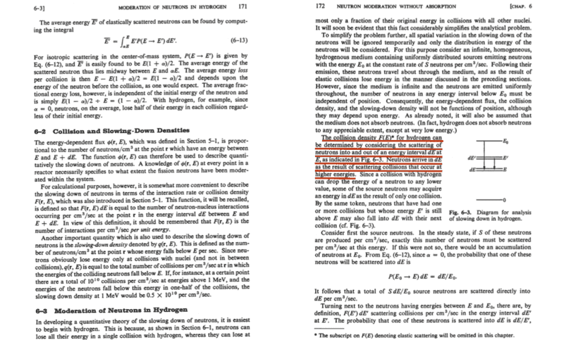

Hi, I'm reading chapter 6-3 of Lamarsh's book "Introduction to Nuclear Reactor Theory". Here it is discussed the very idealistic case of Hydrogen being used as a Moderator (without adsorption).
The moderator is:
- infinte
- homogeneous
- with uniformly distributed source emitting at constant rate ##S## and constant energy ##E_0##
- (of course) made of Hydrogen
- the nuclei are considered at rest.In the book it is said that the emitted neutrons hit the Hydrogen atoms and so they lose energy (this I understand perfectly). As a consequence the author assumes that the only possible outcome of a collision is the slowing down of neutrons.
I do not fully agree and I was looking for some help to better understand this.
My thought about what is "missing":
Neutrons emitted from the source have an amount ##E_0## of kinetic energy and they hit the Hydrogen nuclei at rest so that they transfer to them some of their staring kinetic energy thus they (neutrons) slow down (to an energy level ##E##). BUT the Hydrogen atoms have gained some kinetic energy (and this isn't something to be neglected because Hydrogen nuclei and neutron have the same mass!) and so they (Hydrogen nuclei) are now moving with some velocity and kinetic energy. Now that the nucleus in no more at rest if it collides with a neutron it (the nucleus) may "give back" some of the energy he stole in the previous collision and in this way the new neutron could be accelerated instead.
My possible explanation:
The author doesn't seem to care about the kinetic energy of the nuclei (ie the temperature of the moderator) so I guess he assumes that once the collision has occurred the recoiling nucleus is somehow "stopped" (ie the moderator is cooled) otherwise there would be a loss of energy in the system.
What do you think? Can you help me figure it out?
PS: I also like to know why neutron-neutron scattering is totally neglected. Is that so rare ?
(I upload the first page of the chapter for completeness)
  • Textbook page showing the moderation of neutrons in hydrogen, with equations for energy-slowing-down density and a diagram of slowing down in hydrogen, Fig. 6-3, marked with energies E0, E and E prime.
The assumption is that the nuclei are at rest, or the moderator temperature is at absolute zero. In reality, the practical problem is slowing down fast neutrons so that they are at the same temperature (thermal) as the moderator. The energy that the protons pick up get moderated. The number of neutrons involved is overwhelmingly smaller than the number of nuclei in the moderator.
Ok so basically it is constantly cooled down otherwise this is not possible, right ?

Thank you for all the replies. My problem is: "where does the energy go?"
When the Hydrogen medium moderates the fast neutron to thermal energies it must get hotter (the protons have to gain kinetic energy). If it gets hotter the cross section will change and it will moderate worse (ie neutrons won't slow down very easily).
In order to carry on the approach used in the book one should assume that the temperature of the medium doesn't change (ie the protons do not gain kinetic energy) so one must specify that the system lose energy somehow.

Summing up: I think there must be a way for the system to lose energy. What is it? Does the author simply assume that heat is removed from the system? This might look like a stupid question, but I really hate when little details are omitted (even if obvious) because I wasted a whole day thinking about this.
dRic2 said:
Are you talking about radiation of a moving charge ? That's fine, but if that energy is captured by other Hydrogen atoms then the energy won't leave the system and as time goes by the medium will get hotter.
Yes, and yes. The system is an infinite, homogenous mass of hydrogen. If a uniformly distributed source of emits neutrons, then the neutron population would reach some thermal equilibrium with the hydrogen. None of that is physically real, just hypothetical. Note that the title of the chapter is "Neutron Moderation Without Absorption", also not physically real. Free neutrons don't appear spontaneously on their own, and furthermore, free neutrons don't survive very long (half-life ~ 10.23 minutes). In a pure hydrogenous mass, neutron would eventually slow down and be bound by a proton to form a deuteron, the nucleus of deuterium atom.

The things that is killing me is that the author says:
Neutrons arrive in ##dE## as result of scattering collisions that occurs at higher energies.
Why only higher ? I agree that this is a very special/ideal/non-realistic case, but why not taking into account the possibility that neutrons get speeded up by protons? The protons might be at rest at first (ie at the beginning of the "experiment"), but they are no more while the experiment is going on for a while.
Again we could argue that this is a stupid thing to argue about because this is a very very "un-real" but at the end of the paragraph the author says:
$$ \phi(E) = \frac S {E \Sigma_s (E)}$$
While [the above eq.] is strictly correct only for infinite Hydrogen medium, it is often used to give rough estimates of energy-dependent flux in finite hydrogenous system such as water-moderated reactors.
I know "rough estimates" means nothing, but still... How should this method come remotely close to a real situation ?

The idea is that neutrons start at a much higher energy (e.g., MeV) than protons (at ~eV) in a moderating environment. In light water reactors, the moderator temperature is the coolant temperature, ~270-285°C for BWRs, and 285-330°C for PWRs.
The temperature equivalent of 1 eV is 11604.5 K.
https://physics.nist.gov/cgi-bin/cuu/Convert?exp=6&num=160&From=ev&To=k&Action=Convert
I was simply doing an arithmetic average on the 1 MeV divided into 1x106 protons. A Boltzmann distribution has an average value.
Upscattering of neutrons does occur, but only when the neutron energies achieve energies comparable to the thermal energies of the moderator, protons in this case. For example, a 1 eV proton would have would not increase the energy of a 100 eV neutron, let alone a 1 MeV neutron, but a 1 eV proton would certainly increase the energy of a 0.02 eV neutron. However, in LWRs, the thermal energy of the moderator is on the order of 0.05 eV (~580 K). I'll have to look through my library, but I just happen to read a statement last week that thermal fissions are most likely at 0.1 eV in an LWR. On the other hand, in LWRs, fast fissions account for about 7-10% of fissions in the core depending on the burnup of the fuel.

You are correct in your understanding, but Chapter 6 is only discussing the slowing down region above 1 eV.
You might want to go back and read the first 2 paragraphs of the chapter.
Fission neutrons start off about 1 MeV and slow down to thermal energies, where they will become in thermal equilibrium with the moderator.
The moderator energy is almost always less than 1 eV. For example, at room temperature the most common energy is 0.0253 (given by Maxwell-Boltzmann distribution).
From 1 MeV down to 1 eV, the neutrons will have much more energy then the moderator and you can assume the moderator is at rest
and no neutron upscatter will occur.
At thermal energies, it is a different story and you have to account for the thermal motion of the moderator and upscatter will occur.
The thermal spectrum is covered in Chapter 8.
