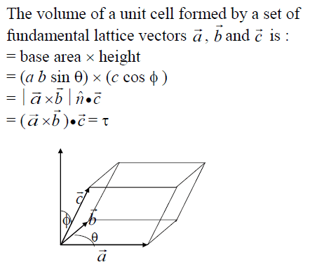

We know the rule of cross product
or
Why here |absinΘ| =
, and
= c cos Φ in the above picture?
Thanks for explanation.
mysci said:
We know the rule of cross productView attachment 79882 or
Why here |absinΘ| = View attachment 79883 , and View attachment 79884 = c cos Φ in the above picture?
|a||b|sinθ is the area of the base, and is also the magnitude of the cross product of ##\vec{a}## and ##\vec{b}## -- i.e., |##\vec{a}## X ##\vec{b}|##. |c|cosφ gives the height of the parallelipiped. The product of the area of the base and the height gives the volume of the cell.
The base is formed by two vectors with lengths ||a|| and ||b|| and angle between them [itex]\theta[/itex]. Draw a line from the tip of line b to the base, the line forming the vector a. That gives you a right triangle with hypotenuse of length ||b||. So the "opposite side", the height of the parallelogram forming the base of the figure. The "opposite side over the hypotenuse" is sine of the angle so [itex]height/||b||= sin(\theta)[/itex] and [itex]height= ||b|| sin(\theta)[/itex]. The area of a parallelogram is "height times base" so [itex]||a||||b|| sin(\theta)[/itex].
Thanks.
Yes, but why not |axb|, is |axb|(unit vector n) in third step?
absinΘ and |axbl are also magnitudes, but |axb|(unit vector n) is a vector. absinΘ = |axb| ≠ |axb|(unit vector n) = vector a x vector b.
However, here absinΘ = |axb|(unit vector n). I don't understand this.
On the other hand, ccosφ is the height of parallelogram, how to change it to vector c? I don't understand it as well.
Thanks.

|a x b| is a scalar, while |a x b|n is a vector that points straight up, and that whose magnitude is the area of the base. If you dot this vector (|a x b|n) with c, you get the volume. One definition for the dot product of a and b is ##a \cdot b = |a| |b| cos(\theta)##, where ##\theta## is the angle between the two vectors. In your problem, the angle is ##\phi##.

I may get something.
In fact,
absinΘ = |axb|
ccosΦ = n·c
Is it right?
I thought absinΘ = |axb|n and ccosΦ = c before I get the above thinking.

Then
I got following,
absinΘ = |axb|
ccosΦ = n·c
Is it right?
mysci said:
Thanks.
Then
I got following,
absinΘ = |axb|
Should be |a||b|sinθ = |a x b|. a and b are vectors, so ab is not defined. Both sides of the equation should be scalars, which is why you have the magnitudes (absolute values).
mysci said:
ccosΦ = n·c
The right side is a scalar because it's a dot product, so the left side needs to be a scalar as well.
The left side should be |c|cosΦ.
mysci said:
Is it right?
