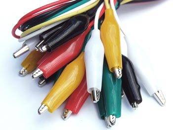

Would this be an option? May be a little more expensive (?)
Gator clips... been there, done that. The leads on which the clips are mounted wear out very quickly.

tfr00 I don't think you get it. Concerning post #8 you would fasten the alligator clip to something solid then the lead attached to it would never move. You just push on the alligator clip and it opens up to accept the lead. I have built a lot of test fixtures over the years for production and the alligator clip mounted solid to a surface is a good idea.
You're right I didn't get it... when I see a picture of alligator clips on the end of leads, without further explanation, that what I think of. But yes, that also seems like a good idea.
