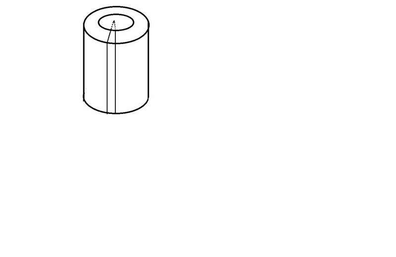

A hollow metal cylinder has inner radius a, outer radius b, length L, and conductivity sigma. The current I is radially outward from the inner surface to the outer surface.
Find an expression for the electric field strength inside the metal as a function of the radius r from the cylinder's axis.

No no, I think you misunderstood me. Check out my attachment. I have marked out a segment right? Imagine that segment to be subtending an infinitesimal angle at the center. What would its resistance from the inside to outside be?
Well, if it's an infinitesimally small angle, then wouldn't the cross section just be a rectangle, and the area would just be outer radius - inner radius * L, so (b-a)L.
Edit with the resistance: R=L/(b-a)Lσ, and L would cancel, so it would just be R=1/(b-a)σ.

The current is flowing normal to the lateral surface. So what then will be the cross section area?
(assume that the angle subtended is dθ)
Would it have to do with arc length? Assuming θ is in radians, then the arc length would be s=r(dθ). Then the cross section area that the current passes through would be A=r(dθ)L.
Yes, you are in the right direction now. Proceed to find the segment's resistance and hence the net resistance.
So since A=r(dθ)L, and R=L/Aσ, then by substitution L cancels and R=1/r(dθ)σ for the segment. If we were to extend that all the way around the cylinder, then the total θ would be 2\pi, so R=1/2\pirσ.
