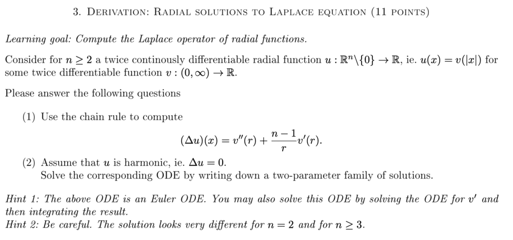

Part 1
$$\Delta u(x)=\Delta v(|x|)$$
Substitute $$|x|=r=\sqrt{\sum_{i=1}^n{x^2_i}}$$
$$u'(x)= v'(r)\frac{\sum_{i=1}^nx_i}{\sqrt{\sum_{i=1}^n{x^2_i}}}$$
$$u''(x)=v''(r)\frac{\sum_{i=1}^nx_i}{\sqrt{\sum_{i=1}^n{x^2_i}}}+v'(r)f(x)=v''(r)+v'(r)f(x)$$
$$f(x)=\frac{n\sqrt{\sum_{i=1}^nx_i^2}-\frac{\sum_{i=1}^nx_i \sum_{i=1}^nx_i}{\sqrt{\sum_{i=1}^nx_i^2}}}{\sum_{i=1}^nx_i^2}=\frac{nr-(\frac{r^2}{r})}{r^2}=\frac{n-1}{r}$$
$$u''(x)=v''(r)+\frac{n-1}{r}v'(r)$$part 2
make the substitution $$v'=a$$
$$0=a'+\frac{n-1}{r}a$$
$$\frac{a'}{a}=\frac{1-n}{r}$$
$$\frac{d}{da} ln(a)=\frac{1-n}{r}$$
$$ln(a)=\int\frac{1-n}{r}dr$$
$$ln(a)=(1-n)ln(r)+C$$
$$a=Cr^{1-n}$$
$$v'=Cr^{1-n}$$
$$v=Cr^{-n}+D$$
##v'=Cr^{1-n}## is ##C\over r## for ##n = 2##. How do you make the last step ?

when ##n=2##, ##v=C+D##. when ##n=3##, ##v=\frac{C}{r}+D## so the solutions look different for ##n=2## and for ##n≥3##

I don't think that with your answer the equation ##v^′=Cr^{1−n}## is satisfied :rolleyes: .
oops.. yes you're so right.
$$v=C\frac{r^{2-n}}{2-n}+D$$
With ##n=2## ? :mad:
Sorry sir, the solution is ##v=Cln(r)+D## with ##n=2##
If this is correct, then the solution to the ODE ##0=v''+\frac{n-1}{r}v## is
##v=C\frac{r^{2-n}}{2-n}+D## with ##n≥3##

You have $$u(x_1, x_2, ... , x_n) = v(|\vec x |) = v(r) = v\left (\sqrt{\sum x_i^2\ } \ \right )$$Now we need $$\Delta u \equiv \vec \nabla\cdot\vec\nabla u\ = \vec\nabla\cdot\left ({\partial u\over \partial x_1} , {\partial u\over \partial x_2}, ... ,{\partial u\over \partial x_n}\right ) $$ for which the most useful form here is $$\Delta u(\vec x) = {\partial^2 u\over \partial x_1^2} + {\partial^2 u\over \partial x_2^2} + ... + {\partial^2 u\over \partial x_n^2} = \sum {\partial^2 u\over \partial x_i^2} $$
and this is where we are going to throw in the chain rule. Want to try ?

$$∂_{x_i}\left[v(|x|)\right]=∂_{x_i}v(|x|)\frac{x_i}{\sqrt{x_1^2+...+x_n^2}}$$
Right. Or$$r^2=\sum x_i^2\Rightarrow 2r\,dr = 2\sum x_i\,dx_i
\Rightarrow {\partial r\over \partial x_i} = {x_i\over r}$$Chain rule:
$${\partial u(\vec x)\over \partial x_i}={\partial v(r)\over \partial x_i}
= v' \,{\partial r\over \partial x_i}= v'\,{x_i\over r}
$$as you had. Chain rule again:$$
{\partial^2\, u(\vec x)\over \partial x_i^2}={\partial \over \partial x_i}\left ( v'\,{x_i\over r}\right )=
{\partial v'\over \partial x_i}\, {x_i\over r} + v'\,{\partial x_i\over \partial x_i}\,{1\over r} +
v'\, {x_i}\, {\partial \over \partial x_i}\left({1\over r}\right )
$$Three terms. First one:$$
{\partial v'\over \partial x_i}\, {x_i\over r} = {\partial v'\over \partial r} \, {\partial r \over \partial x_i}\, {x_i\over r}= v'' \, \left ( {x_i^2\over r^2} \right )
$$Second one: $$
v'\,{\partial x_i\over \partial x_i}\,{1\over r} = v'\,{1\over r}
$$ Third:$$
v'\, {x_i}\, {\partial \over \partial x_i}\left({1\over r}\right ) = v'\, {x_i}\, \left ( -1\over r^2 \right ) {\partial r \over \partial x_i} = v'\, {x_i}\, \left ( -1\over r^2 \right ) \, {x_i\over r} = - v'\, {x_i^2 \over r^3}
$$Collect the three again: $$
v'' \, \left ( {x_i^2\over r^2} \right ) +
v'\,{1\over r} -
$$ and now we do some summing up to write down ##\Delta u## (see post #10) : $$
\begin{align*}
\Delta u(\vec x) = \sum {\partial^2 u\over \partial x_i^2} &=
\sum v'' \, \left ( {x_i^2\over r^2} \right ) +
\sum v'\,{1\over r} -
\sum v'\, {x_i^2 \over r^3} \\ \mathstrut \\ &=
v'' + v'\,{n\over r} - v'\,{1\over r} \\ \mathstrut \\ &= v'' + {n-1\over r}\,v'
\end{align*}
$$as dangled in front of us in the exercise.
Now it's me looking cross-eyed from all the cut&paste ##\TeX##. It was fun, though.
I promise to look at your post #11 when I recover tomorrow, and point out where things derail (if at all :rolleyes:).
Although it seems your only issue was with the cross terms, and I hope I have shown that they don't pop up at all.
