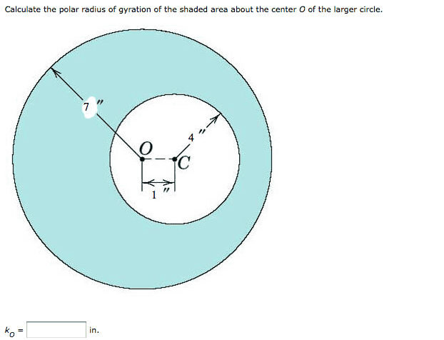

i guess its r=sqrt(I/A)
where A is the area of the circle thing and I is the moment of intertia.
I guess I'm just having trouble getting I. A is 33pi
what have you tried?
finding the centroid of the shape.
were you able to find that? I think there is a better approach: I = I_outer - I_inner . (be careful that everything is calculated about O).
how do I find I_inner ?
The moment of inertia of a uniform disk around its center is 1/2MR^2. However, the inner disc (the empty region) is not centered on O, but on C. You have to use the parallel axis theorem to account for this.
so according to that...
1/2*49pi*7^2 [I_outer] - (1/2*16pi*4^2+16*1)[I_inner]=3319
3319/(33pi)=32
sqrt(32)=5.66
And that was right...
thanks guys. I understand it a little better now..
